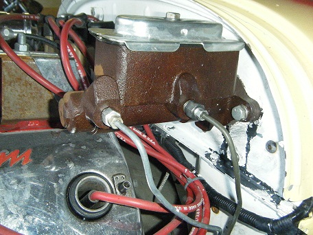

    man, I had 40 Ford brakes with buick drums and it stopped on a dime. The finned drums help cool the shoes, so it stopps faster. If set up correctly they work great. You may need to adjust them, make sure the rear brakes are good too. What master cylinder do you have ? and what size lines ?

    1. Kill the hydraulic problem and get the air out.
    2. Get the shoes and the drums to the same radius.
    3. Stop.
  4. No don't stop there make sure the entire car is deratified.
    Jalopies forever.
    I just noticed something in this pic, see where the master is leaking down the firewall and destroying the paint? If your master is drooling all over your friewall it is usually a good indication that you either need to replace it or rebuild it, if fluid can get out past the piston and seal air can get in.

    I would love to keep this setup and stay away from disk. And it sounds like these brakes are plenty good. So I will stick with it and make them work. As for the paint rot, that's from me having the MC lid off and doing sloppy poors while bleeding. It's not from leaking. I will replace the lines and joints between the MC and WC. As far as what MC I have, no clue. There are NO markings on it to cross reference.

    Well, after all the good feedback from those that responded, I've decided to make these drums work no matter what. I pulled the drums back off last night to look at the wear pattern on the new shoes and drums. They're was hardly any on the front pads and zero on the back. Had a friend step on the peddle while I watched the wheel cylinders and they aren't moving hardly at all. Soo, I think it's the air problem. I'm not getting enough juice to the wc's to push the shoes out. I will be pulling the master cylinder off tonight and see if I can luck out that Napa may have one, but not holding my breath. Also noticed when I press the brake, the whole master cylinder ***embly flexes upwards. It's held on by just the 2 mc bolts on the firewall. So I'm losing some of the peddle to flex. So I'm going to make a 1/4" backing plate to mount on the inside firewall to help with that. Hopefully a new MC fixes my air problem and I can get some actual contact from my shoes.
