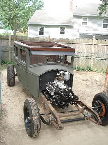

    I used wood, but this is a buick

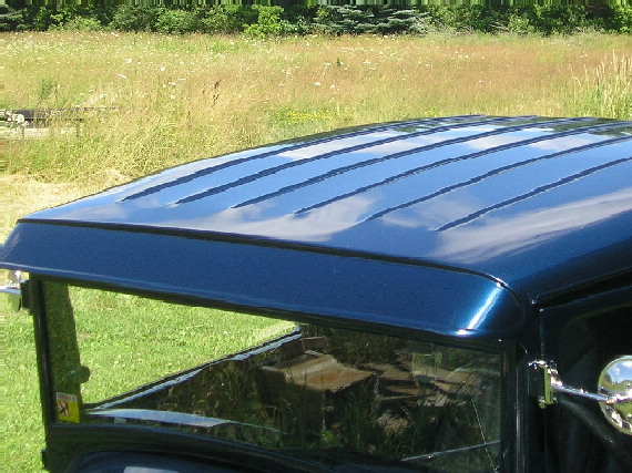

    I have seen people use the top out of a van or station wagon, has ribs for strength. Looks good as well, all depends on what you want it to look like.
