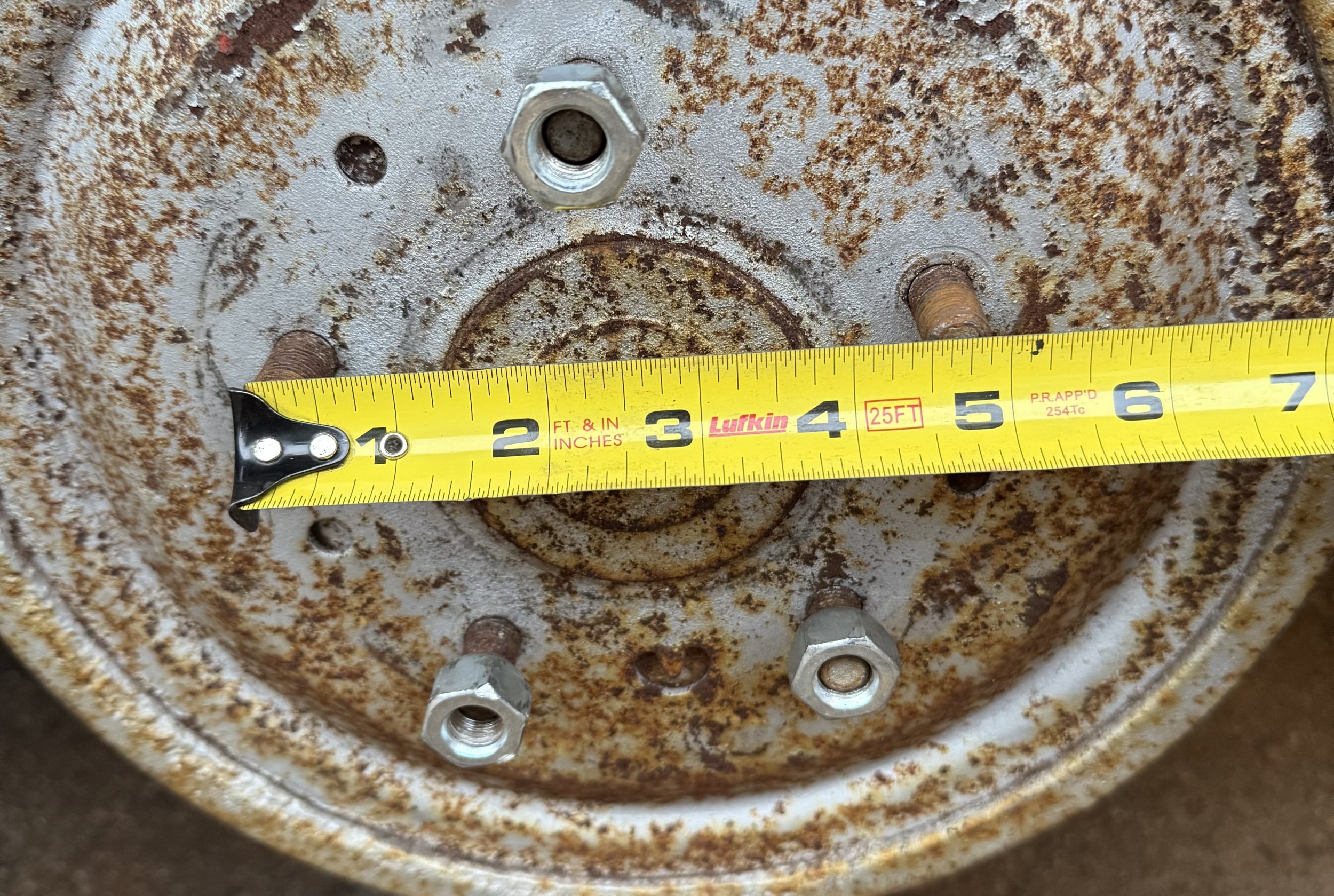

    Yeah I tried to upload a picture of how I was measuring it but the picture was too big. I knew those comments were coming…… I’m measuring it correctly. Like fastcar1953’s picture shows. I’ll try and upload some more pictures but I guess my camera is too good lol

    There's sure not much of the center sticking through the drum either. Looks a little odd. Maybe it's just the angle I'm looking at it.

    Looks like chevy 5 x 4 3/4. Tape measure looks a little off.
    Do the wheels fit but just the wrong pattern?
    Most metric rear ends would have disc brakes.
    Lug nuts std or metric? That would help.

    Being a wood worker my whole life I have to ask, is the tip of your tape measure bent do to frequent droppings?

    It’s normal, that’s how early 8.2’s with drop outs are.

    What I would do is to put a wheel nut on the two studs, using a vernier gauge measure the distance between the two nut flats, call this measurement "A". Measure the width of the nut, call this measurement "B". Take half the measure "B" from measurement "A" and you have an accurate measurement.
