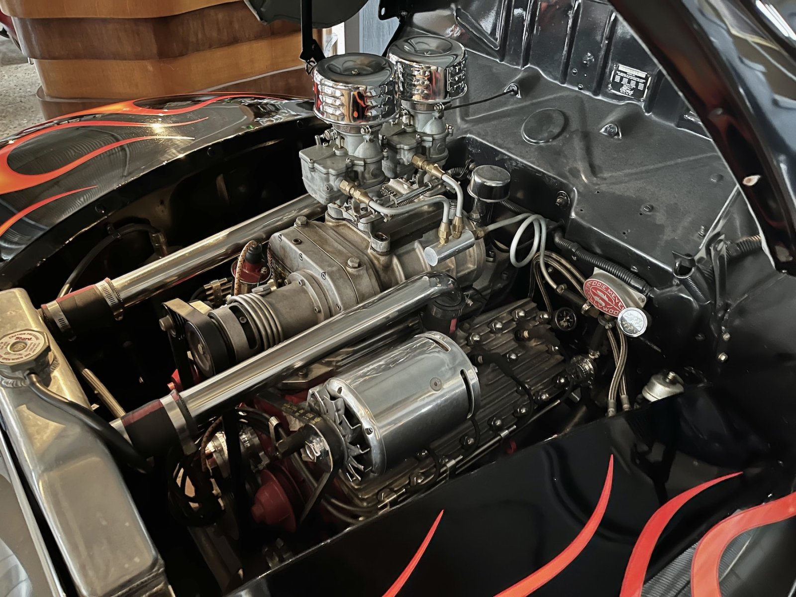

    Hey Gang, I just bought a killer '40 Ford here on the HAMB with a Weiand blown '48 Merc flathead. I've never owned a flathead V8, or a supercharger, so probably had no business buying this, but it was just too cool not to try the learning curve. It was advertised as a turnkey daily, so first task was to drive it home over 200 miles, which the car did without issue, smooth running mill...not much sound from the supercharger (I expected it to whine a bit). Next day took the car to breakfast, all good. Returned home and when backing into the garage the car started whistling Dixie to high heaven, a sound I've never heard from any car, like a teapot at full boil. See/hear attached video. Is this the supercharger? Gasket leak? I don't even know where to start. Worth noting, after the car cooled down I restarted and the sound disappeared or became super faint, maybe some heat expansion causing a leak? Any wisdom would be greatly appreciated!

    Hey y'all! The whistling continues! I tried tightening the intake and carb hold-down bolts to no avail. Covering up the carbs with my hand to constrict airflow does not seem to affect the whistle. One additional phenomenon to note; when the engine is loaded (in gear and driving) the whistling subsides. The whistle is much more prevalent during idle or when the engine is not under load. I was thinking about starting to spray starter fluid or carb cleaner around to see if I can get an increase in RPM such as what @Hotrodmyk suggested...this will be the next step. Thanks for your input!

    LEAK FOUND! I got really close with a garden hose but not right on it, because the pinhole was hiding right behind the driver's side radiator hose at the intake (to block) gasket...there is also only about 1/8" between the cylinder head and intake at this location, so just a tough spot in general. From talking with Joe Abbin of Roadrunner Engineering (supercharged flathead guru), this intake gasket failing is virtually unheard of.
    I was able to pinpoint the leak using distilled water in a turkey baster to precisely drop water around the area. When the water was ****ed in the whistle was silenced. This method worked very nicely, very clean and precise. Now to the fix. I might temporarily apply some high temp silicone to the area until I get around to tearing off the blower and intake to replace that gasket. Thanks to all who commented, and especially to Joe Abbin for his wisdom.
