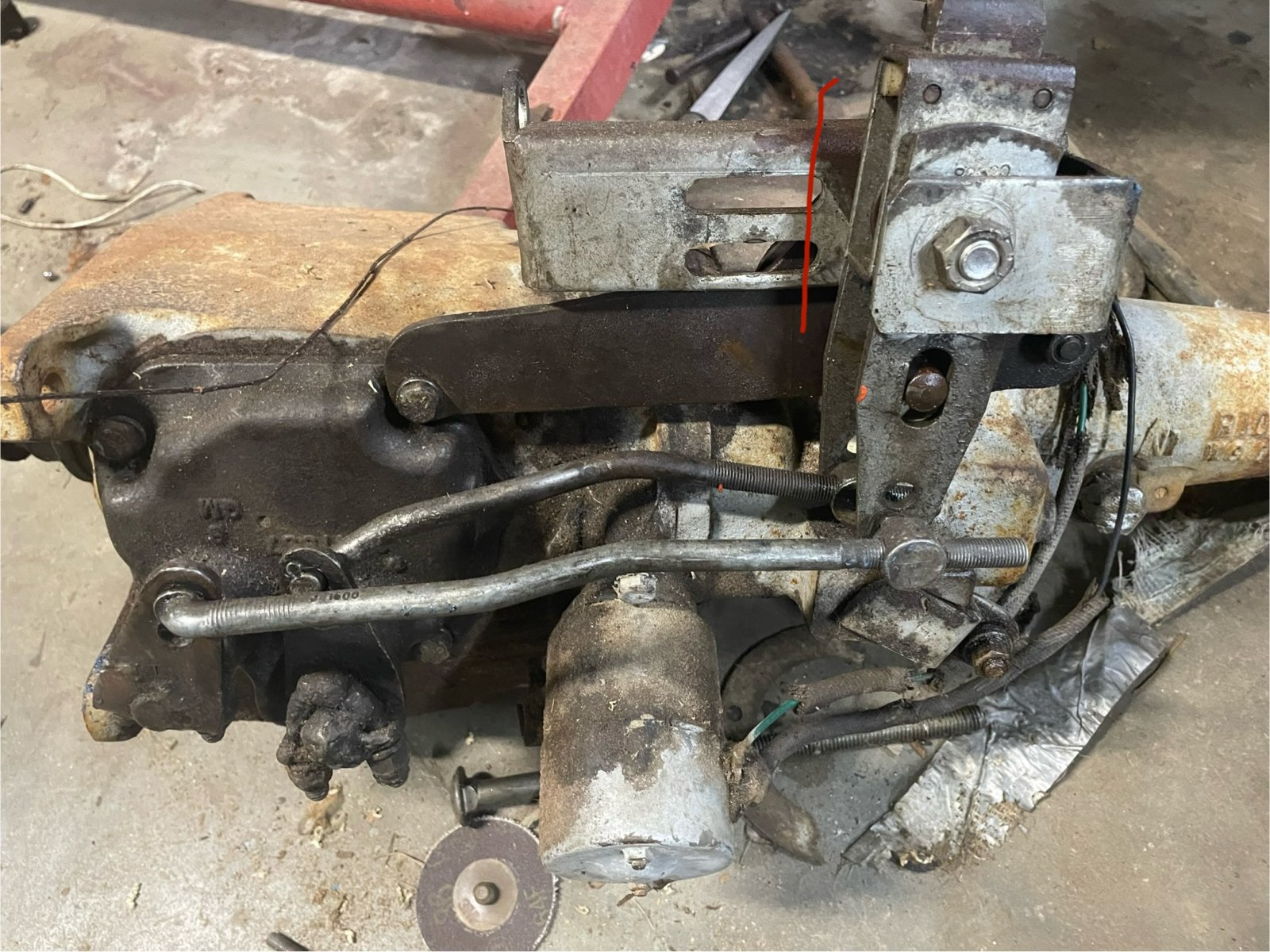

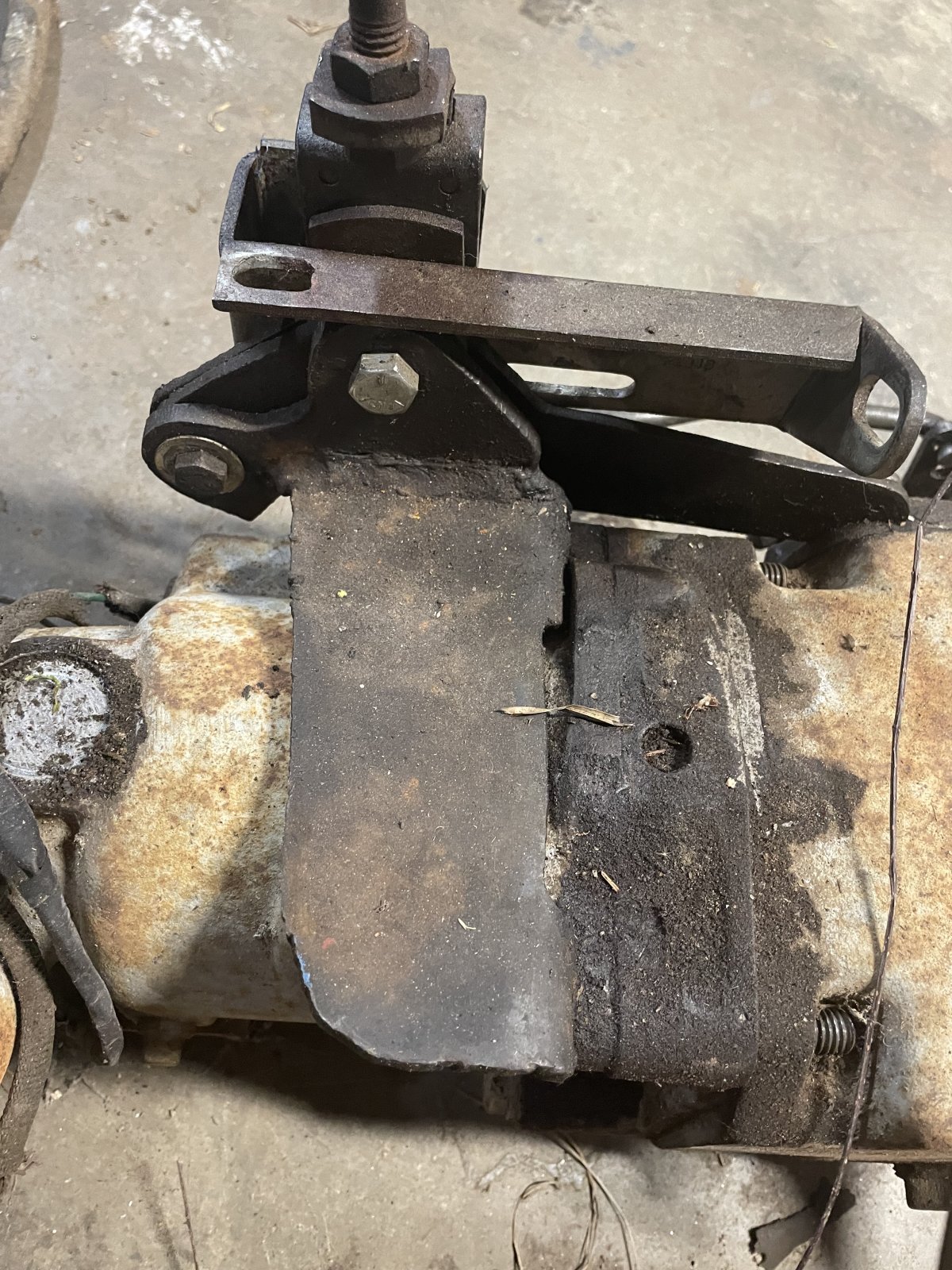

  8. Here ya go
    Bought a Muncie 319 with this shifter mount and rods. The shifter that came with it was shot. So I added an old 3 speed shifter I had in an old parts car.
    The mount and creative shifter arms were built by a cool old guy decades ago. The mount was built like the correct 3 speed OD shifter mount. I’ve seen one NOS OD shifter and its mount looked just like this. IMG_2296.jpeg IMG_2297.jpeg
    I mocked up the shifter to see if it worked. Shifts fine. Needs cleaned up and the aftermarket shifter mount trimmed at the red line. Floor clearance? Don’t know.
    It’s crude but effective.
    Plan on cleaning things up a bit.
    The welds on the shifter arms? Well
    Don’t know. Might just leave em cause I liked the guy that done it
