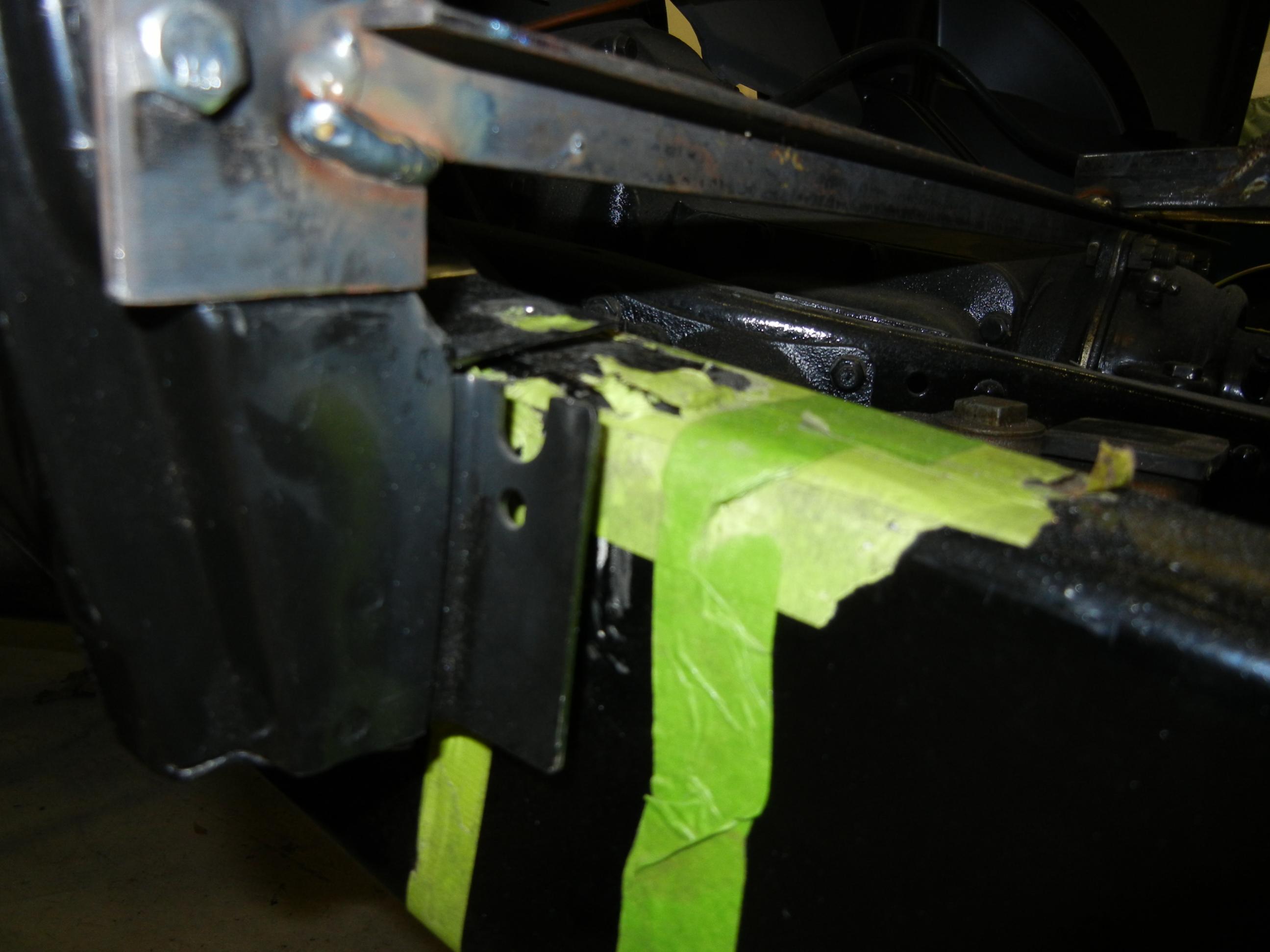

    I am replacing the the rocker panels and floor in my 40 coupe. I noticed that when i was test fitting in the front rocker panel there was a gap between the closed door and the rocker panel. There was no floor in my car so i dont know if it ought to be flush or not. When i look at where the rocker attaches to a and b pillars seems to be gap of about 1/2 in or so.
    Also can anyone tell me how the bottom of the qtr panel attaches to rocker. There seems to be a lip on part of the rocker but not back where the rear fender starts and the frame begins to kick up, here it is straight. Is there something else between the qtr panel outside and the rocker?
    Any pictures,info or pointers would be appreciated!

    thanks for the pics and info, i had found these thru a search and they helped. i have attached some pics and more specific questions that hopefully will make more sense than my last rambling!
    first off i am ***uming (yea this always gets me in trouble) that the rocker attaches behind the tabs at the a and b pillars show here:
    these pics show the gap with door closed between bottom of door and the tabs to attach rocker. there is also one of the rocker laid above these tabs just for purpose of estimation how well it fit the door curve.
    then finally my quarter panel rocker attachment. here is a pic of the rocker and i see the bend to attach quarter. my question is more toward the kickup area. the rocker comes straight down and the quarter would meet it at 90 degrees with no lip for attachment? i have attached a pic of the area in question...
    sorry to be so long and detailed but i am stuck and i know lots of folks on here have done this more than once! man i wish i had a reference to go by!!

    There is a gap (about 1/2") between the rocker and the door bottom. The rubber on the scuff molding goes against the door bottom and makes the seal. Keep this gap the same along the door bottom when you weld in your rocker and you will be fine.

    Folks, thanks very much for the help. I think i now know enough to be dangerous. I figured there were some folks on here who had been there done that.
    Keith thanks for the additional pics extremely helpful.

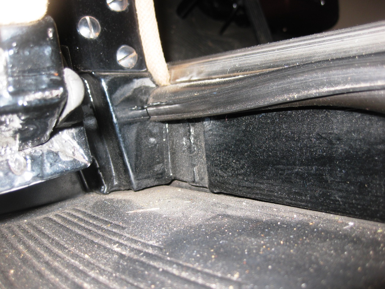

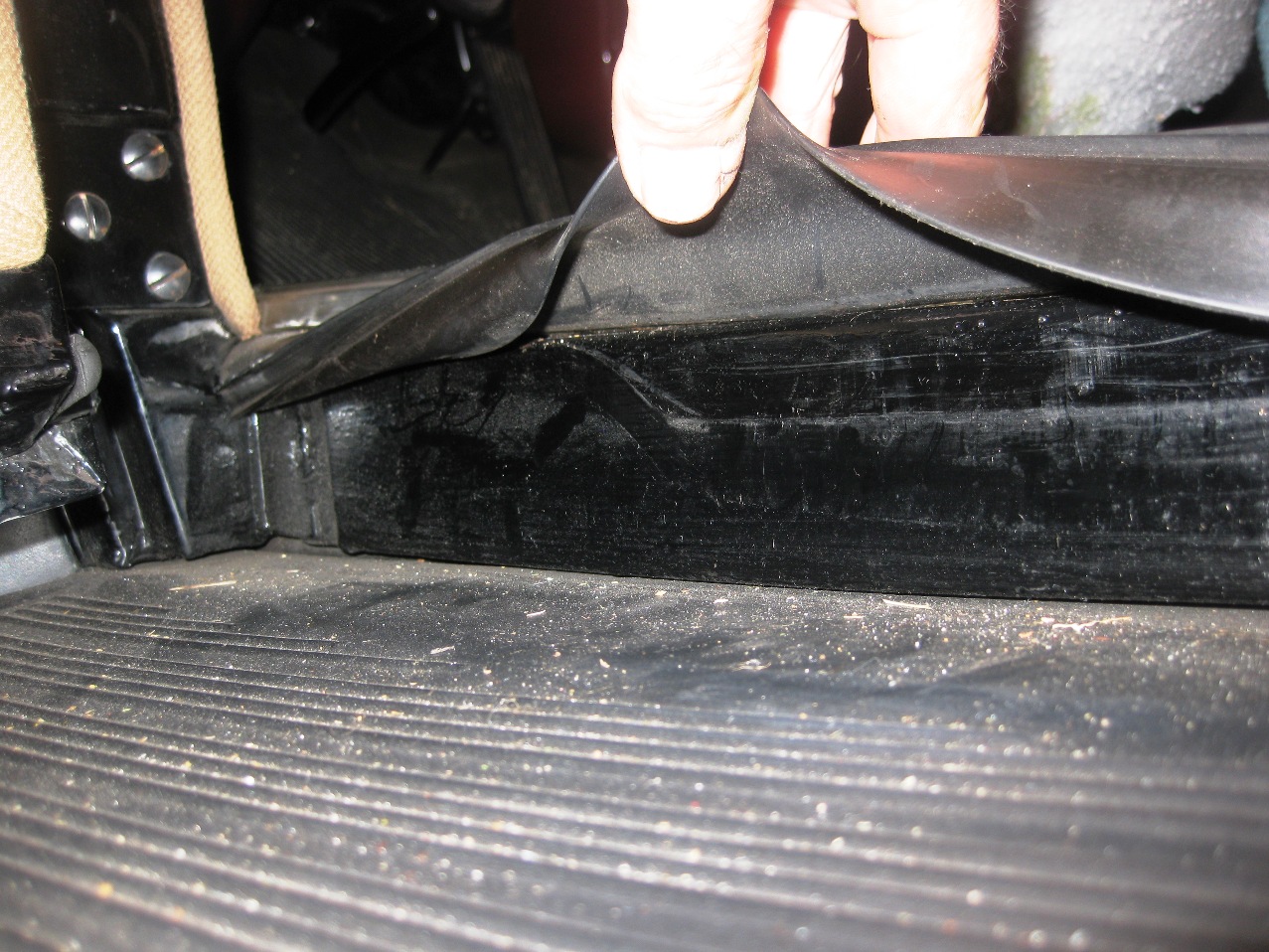

    Here are some photos of what the faactory floor rocker looks like all done. Hope it helps in some way. The rubber door seal is from Bob Drake.

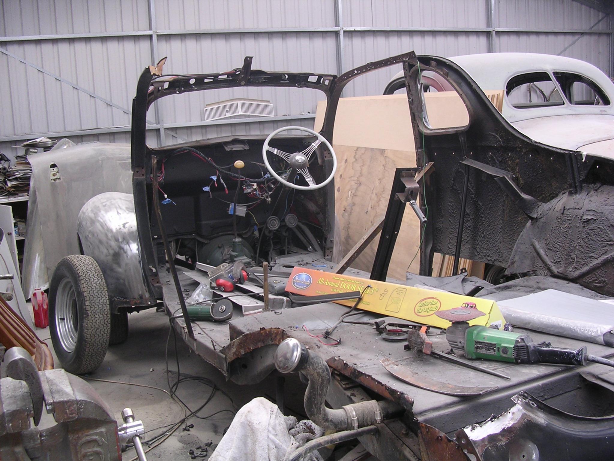

    I've got a 39 coupe here stripped down to the floors...let me know if I can help...

    guys thanks for the xtra pics. 19fordy the seal shots were perfect. thanks

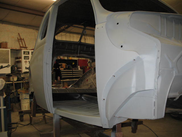

  15. 19Fordy
    Joined: May 17, 2003
    Posts: 8,372
    19Fordy
    Great. Here's a few more. Just in case.
