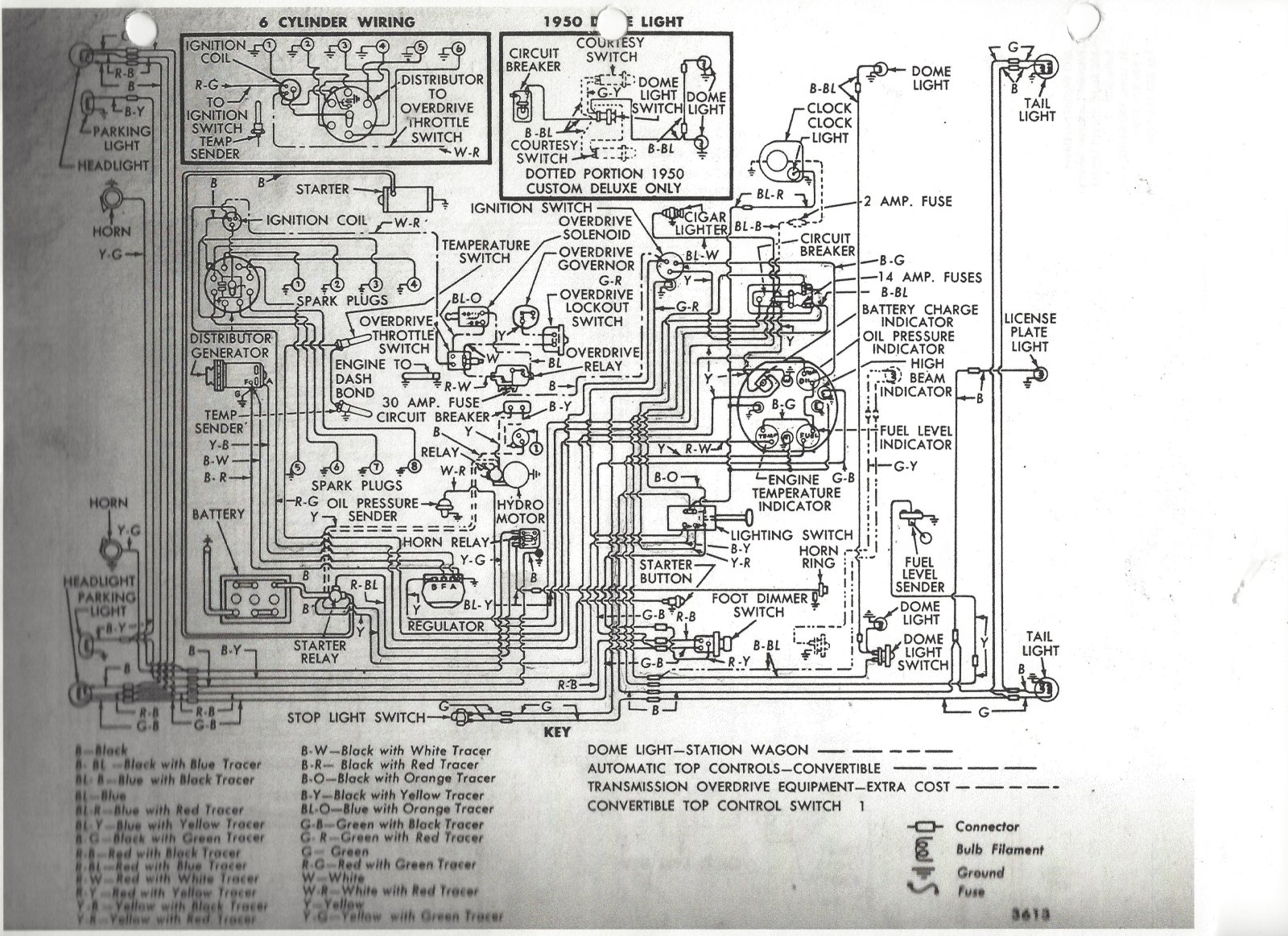

    twenty8

  8. In reading the OP post, I think he is leaving it 6V positive ground and just asking if everything he hooks up needs to be hooked up backwards. A 49 Ford wiring diagram is the best way to confirm.

    Why not just look at the wiring schematic for the car?

  15. In answering your last question, the basic answer is yes. As posted previously, a wiring diagram will help you greatly. Think about it this way- every "lead" you hook to something needs to be negative, and every "ground" needs to be positive. Lights and gauges (except ammeter) do not care about about the polarity. The ammeter and coil will need to be wired correctly, as does the starter. Crossing polarity among different things will be where the issue will arise.
