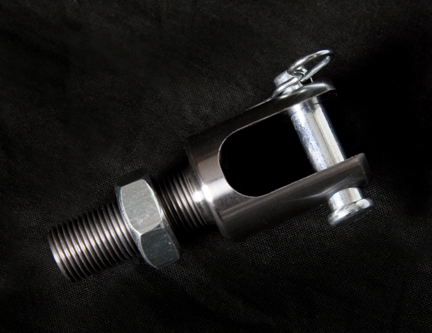

  3. Sprint cars use a clevis as part of the locating linkage for the rear axle.
    It's already sized for a Heim joint like you might use on a panhard bar. You could just drill a hole in the batwing and put it through like a bolt, then attach the heim joint in the yoke.
