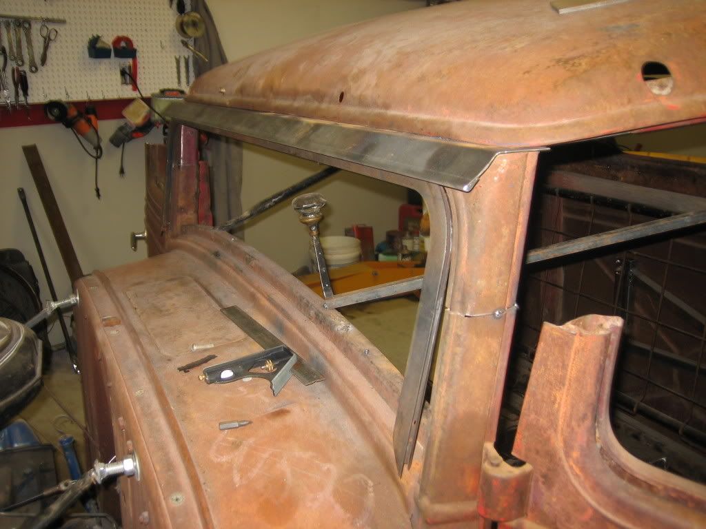

http://i227.photobucket.com/albums/dd8/shanesflames/IMG_3857.jpg I would like to lean the A- piller back aprox 3/4".pie cut......the door hinge is in the way..do i have to move this??to chop in this way??
you will have to move the hinge back to its original spot,the hing pins must line up for the door to open.
You could always move them to the back of the doors - suicide doors ya know . or you could move the top hinge down below that belt line . Randys right about the pins being inline and a good way to line them up is to pull the pins and use a long rod that will go through both hinges at once . Nice job on the cuts by the way .
