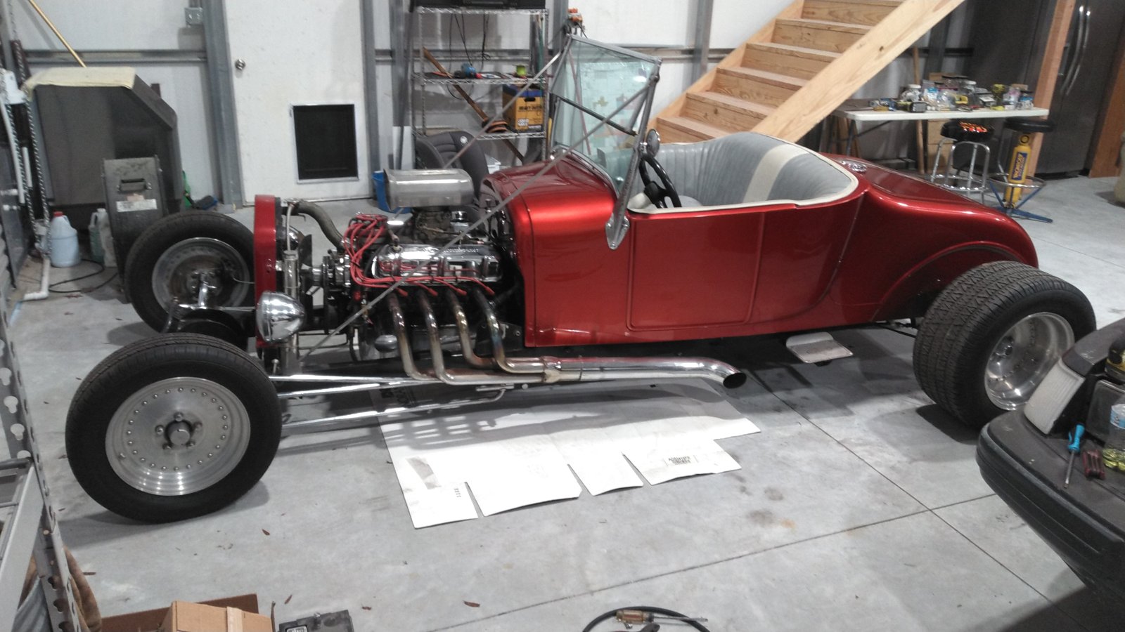

    Hello, just picked up this "car" and could use some experienced input and identification help.
    I'm new to these style of hot rods but always wanted one.
    It's built on what looks like a factory built frame but has some unsatisfactory additions in my opinion.
    ***led as a 1978 ***embled. Built in Michigan as the vin starts with Mich.
    Took me a couple weeks to get it running and moving, still working on making it stop safely.
    Took it around the block this weekend for a shakedown run and found some issues.

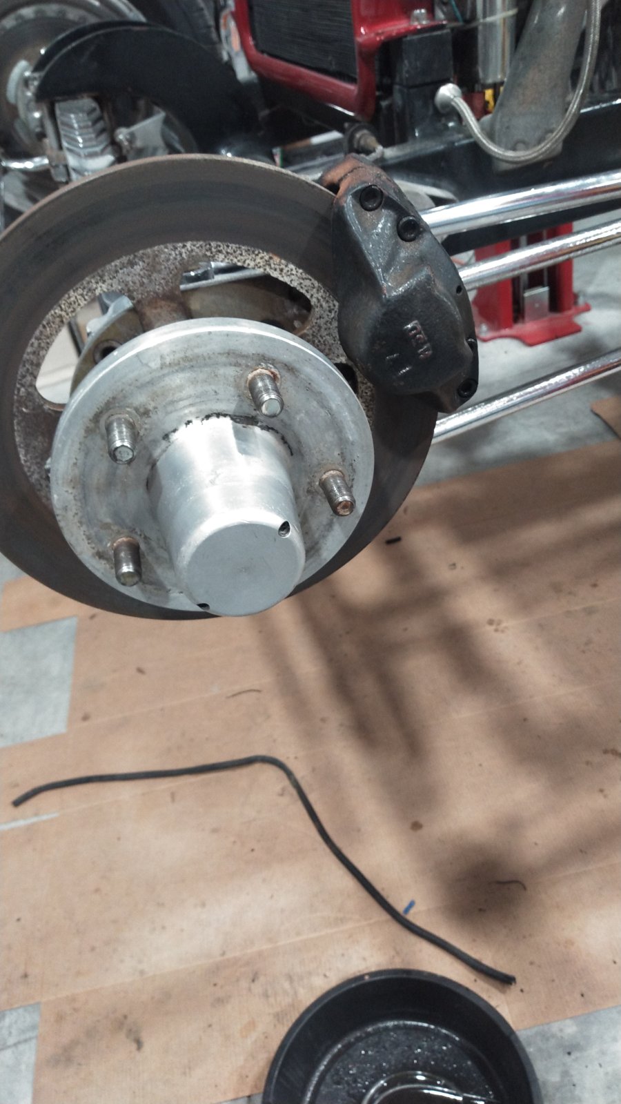

    First things first, what is the proper term to call this? Is it a t-bucket? Is it a roadster? The body is fibergl*** and appears to mimic a 27? It's got a 1966 Ford 289 with a C4 trans. Has a Ford 9" but no clue on the year. Previous owner didn't have any info other than he bought it in the 80's and enjoyed it. Currently showing 15k miles.
    Any idea what these hubs and front brakes are from? KIMG0638.JPG KIMG0634.JPG KIMG0638.JPG KIMG0634.JPG KIMG0633.JPG KIMG0582.JPG

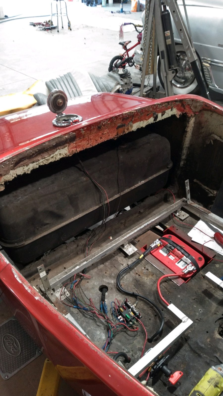

    Second issue is rust in the tank. As far as I know it wasn't ran in at least 5 years. It looks like the tank was the installed before the body or maybe the interior so no easy way to remove it and clean it out. Any tips?
    It has a gl*** filter on it now but it plugs in 10 minutes. And then kills the battery (New optima) trying to get the mechanical pump to refill the carb after cleaning the filter.

    KIMG0623.JPG I'll be adding to this post so feel free to add any input on this car. I'm putting together a folder with information so if you can identify something on it let me know. So far I can identify most of the drivetrain based on Ford part numbers but I would like to know about the other parts used. It looks like someone put some money into it when building based on the amount of chrome plating. The oil pan, alternator, engine brackets and other pieces including the rear axle are factory Ford parts that have been chromed.
  4. Any idea what these hubs and front brakes are from?
    The spindles are '42-'48 Ford. The brakes look to be aftermarket kits with GM calipers. The rotors are ?????

  5. Looks like your typical 80s built 26/7 Roadster on a T bucket style frame.

    It's a roadster ,a T bucket has no turtle deck. I would expect the rotors to be GM with adapters to fit bearings to Ford spindle.

    This is what I would call it too. I don't consider any 26/27 T roadster to be a "T bucket", to me that only refers to the earlier T roadster bodies on an altered wheelbase.
    I'd be concerned with that front end setup, the steering link in front of the axle is not a great idea (although people do it), read up on Ackerman angle/Ackerman principle, I think the location of the steering tie rod ends is going to give you tire scrub issues. I personally am not a huge fan of the axle pushed out a foot in front of the radiator either, although that's a personal taste thing. The old chromed I beam axle/spindles and chromed leaf spring is pretty cool though. I like the cast aluminum headlight stands too. There's some neat pieces here, but I think you're on the right track giving the car a once-over and redoing some things.

  9. Calipers look like possibly Volvo. 70s, 80s etc
    Rears used in the front

    Those front brakes look like mine. As far as I know they are tpye3 VW calipers. The rotors I don't know, mine were cracked so I replaced my front brakes.

    Front brakes/hubs look like an old Superbell kit.​

    After researching the possibility of VW front brakes I found pictures of super bell super stopper kit that uses the same hubs I have too, so probably what they are.

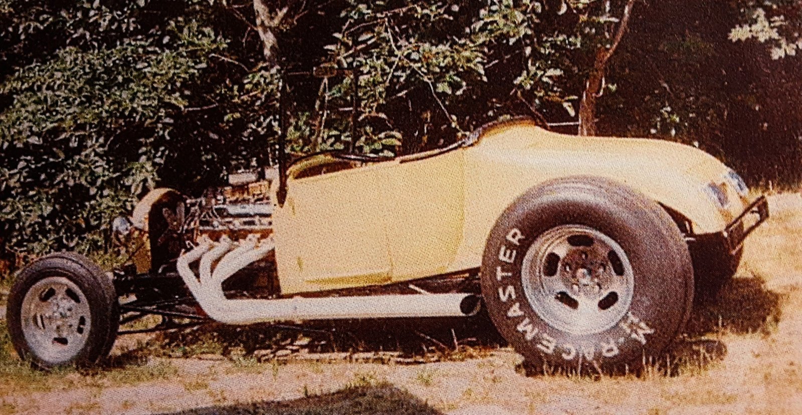

  16. Squablow

    Next issue is very rusty fuel tank. 1/2 of debris at bottom. I previously added a good filter system but it was still allowing rust powder for lack of a better term through it and ended plugging my new carb within 10 min of running.
    Of co**** the interior was built in after the tank was installed so had to destroy the interior to pull the tank. Currently looking for something aluminum that will work with the center fill. Any guesses what the old tank was from? Somebody crudely modified the fill tube. It leaked and so did the sending unit. Unfortunately the way the car was built there was no way to get to it. 30460.jpeg

    Good to here you got the brakes fixed...I would check with speedway motors the have tanks for there 27 t roadster kits
    This one here is a 5gal. 8"x24" they have 10gal. 10"x30" they also have them with sending units they have others also, early vw bus tanks were used in them also, but they are hard to find now, I have also seen the plastic tanks for that set up . 16767925071602087338177876667347.jpg

    The company Jaz also makes fuel tanks and fuel cells some rectangular that might work for you. Here is website: https://www.jazproducts.com/

    Thanks for the input. I ordered a tank from spun aluminum tanks that looks like it will work great. Now just more waiting

    Brakes are VW calipers and Super Bell hubs with rotors, if memory is right
    If your rotors are bad, I have a pair of NOS. PM me if you’re interested.
    It looks like from the pics that you might have clearance enough to switch sides with the spindles,

    Calipers are VW . look like two pin pads. Mine are single pin .
    Are your rotors 10.5" or are they smaller diameter.

    Tank looks a lot like a Triump Spit fire tank I saved out of one years ago . Not sure.
