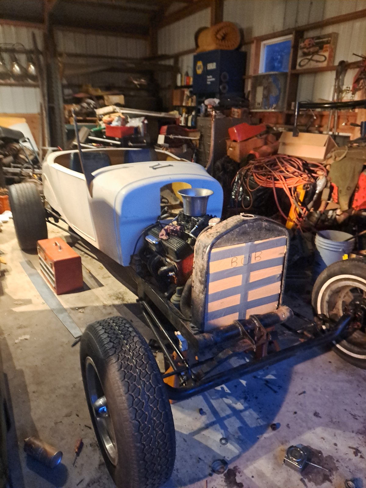

    You know the struggle then of dealing with someone else's build skills. You can tell mine was built with good intentions and some good parts. Unfortunately some of the execution wasn't what I would call acceptable. It's difficult for me to not want to totally rebuild it lol. I'm forcing myself to prioritize safety ( as much as can be expected in a four wheeled motorcycle) and reliability first and then worry about looks. It is interesting trying to figure out the what and why of this build.
    I wish I knew some local car guys that are familiar with t-bucket type cars to look it over and give me honest opinions on topics too lengthy to type lol.

    If I build one myself it would definitely be taller like yours. Is your cowl cut for clearance of the distributor? In my search for front brake options I found this wilwood kit. It might clear your 14" wheel?

    The body was cut / hacked before I got it 25 years ago or so . but if I want to run the radiator were is should be and the rear wheels were they need to be then it needs to be there to clear a standard Chevy points distributer. Ill be running a big Mallory coil driven magneto maybe, so Ill want some clearance anyway . Why make it harder to work on? . It will clear a Joe hunt vertex now for sure I double checked . Im trying to get the engine another 1/2" back now the water pump shaft is like a 1/4" from the walker radiator . hoping to cheat the rear end back a 1/4 with the heim joints and move the body back 1/4" and the engine a 1/2".
    I have a 30 1/2" long hood Id like to be able to use
    Its cut to be channeled but im going to not channel it and I plan on running a set of model A boxing plates i had cut years back that will formed to the body line . to give it a kind of like its on a 32 frame type look . That my plan this week any way . Sort of a second set of frame rails . should stiffen it up and also give a better place for a roll bar to mount maybe .
    It going to have some HP so Id like stiffen up the frame and give it a bit of side impact protection as well .

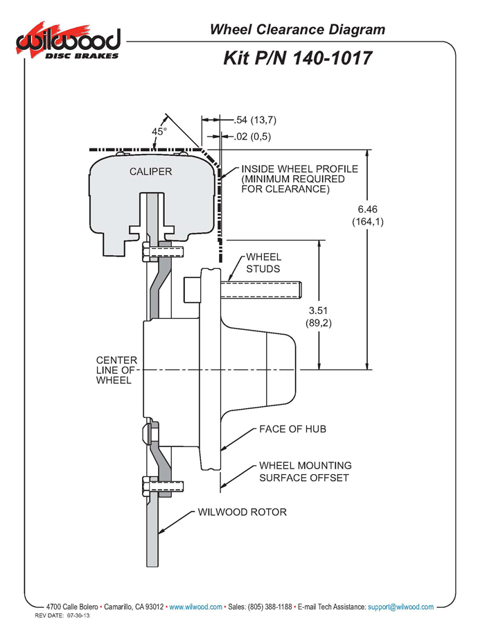

    Those Willwood brakes are expensive and Id like to use the **** I have . this is actually a spare parts build from stuff I collected for a second better build I hope someday .
    Seems like there should be a 10 or 11 " disk brake set up for a stock type ford hub . there is for a Chevy hub and spindel set up . I need/ want to keep the lugs chevy 5 on 4.75 pattern so I can run the other rims and race stuff I have. This might see some light drag strip use ( 300' street drags ) . I may run the Hilborn injection in my avatar with a belt drive pump set up I have .

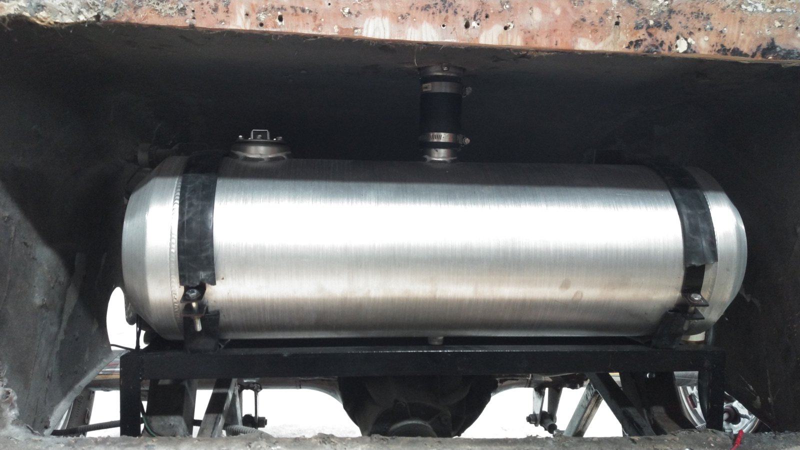

    I did get the fuel system all sorted out, bought aan aluminum tank with a center fill that fit perfectly after making some mounts. KIMG0706.JPG KIMG0708_01_BURST1000708_COVER.JPG

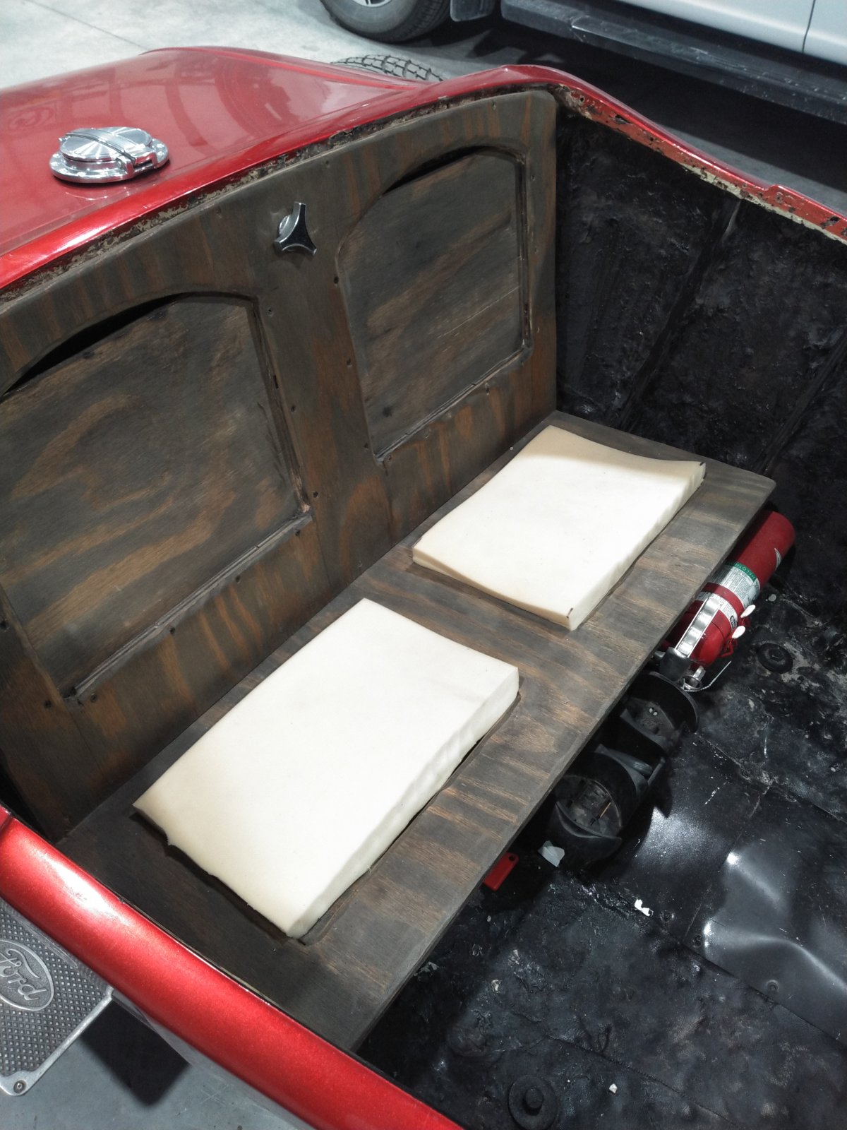

    Still working on getting the interior done. I built a plywood seat so I could try out different positions and angle IMG_20231203_172559.jpg . Settled on this that gives me the most room (6' tall) and still will allow me to get below and behind the seat. Hopefully in January I have an upholstery shop that can fit me in.
