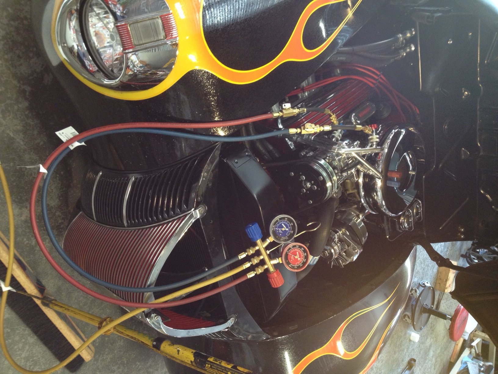

  1. I just got done installing AC in my 40 for my upcoming drive across country. I'm using Alan Grove brackets on a 1970 SBC with the short water pump. I'm getting the dreaded belt squeal with the AC on, mostly at idle. I don't see any way of getting two belts on the compressor with this set up but maybe I'm missing something. Any ideas??
    Sorry about the picture, just tilt your head! :)

  8. Belt alighnment looks good and I have a cogged belt like they suggest. The only pulley that the belt doesn't seat fully in is the water pump pulley. The squealing problem happens mostly at idle. Oh, and thanks for not busting my balls for putting AC in it! ;)
