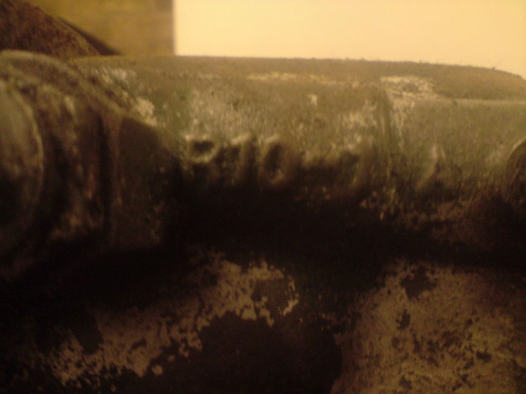

  5. mercurial
    Joined: Nov 23, 2007
    Posts: 42
    mercurial
    Bruce, thanks for that, definitely has R10 cast into it.

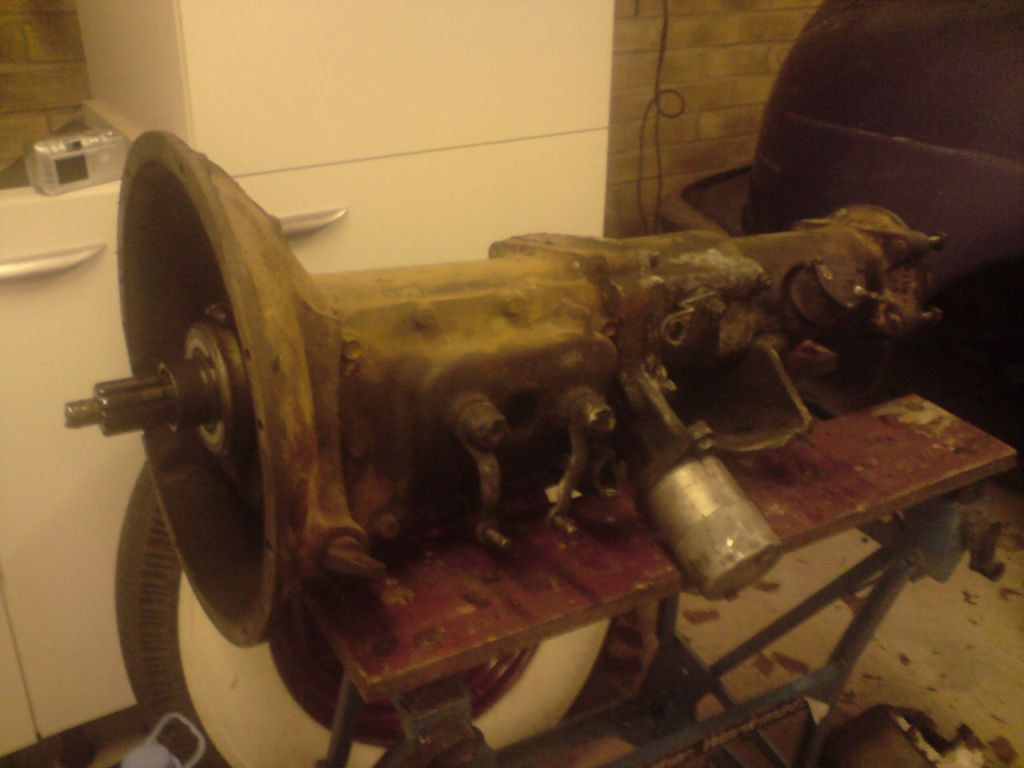

  6. mercurial
    Posts: 42
    mercurial
    Bruce
    Photos now added if thats any help....thanks
    ticks most of the boxes in what you are saying but there is no trace of any electrical controls anymore

  8. Bruce Lancaster
    Joined: Oct 9, 2001
    Posts: 21,681
    Bruce Lancaster
    OK...Is Lincoln. Full mechanical details are in the trans overhaul book, available in repro, and electric setup is detailed in also available Service bulletins...would be same electrically as any '40-60 US car with OD.
    Hotrodded controls are in Petersen's old trans book, too...trans has govrernor and solenoid to control automatic function, you need a generic cable for mechanical on/off of system, and about a hatful of pushbuttons and relays, which can be modern generic stuff I think. By the way, your trans contains probably $700 worth of gears...

  10. Bruce Lancaster
    Joined: Oct 9, 2001
    Posts: 21,681
    Bruce Lancaster
    Electric stuff you have: Protruding can pointed down is solenoid, and probably required some frame modifications to go in there. Aft is an upward pointed can, the governor, and somewhere I believe there will be a small switch I can see on the Merc trans but not the Lincoln pictures. All this plus a kickdown switch under gas pedal, and a relay with ignition interruptor, make overdrive a sort of automatic two-speed when engaged. A cable to the lever locks it out. All electric bits and wiring will be closely similar on all BW overdrive applications.
