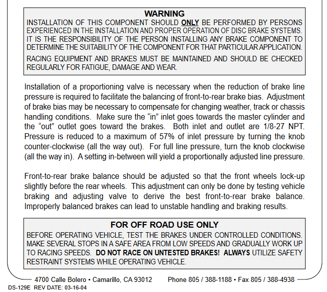

  29. MOONRNR
    Joined: Dec 30, 2023
    Posts: 212
    MOONRNR
    I think the main problem is the PPV misunderstanding in how and why -
    https://shop.wilwood.com/blogs/news/how-does-a-proportioning-valve-work
    Excerpts From Above Site -
    One needs to read the entire TECH ARTICLE.
    The term COMBINATION VALVE ( a unit containing a minimum of two types of brake valves) seems to cause the confusion. One has to understand what each valve incorporated into the COMB VALVE is designed to do.
    The article goes on to state -
    Now with all of this said, you need to read this DISCLAIMER -
