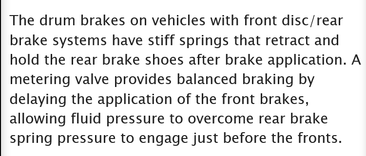

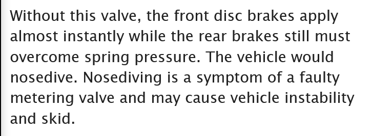

  9. MOONRNR
    Joined: Dec 30, 2023
    Posts: 212
    MOONRNR
    You need a somewhat more current tech source -
    SOURCE - https://www.freeasestudyguides.com/brake-metering-valve-test.html
    Simply put, on a DISC/DRUM car, the front disc will engage long before the rear drum brakes are energized.
    It takes a while for the fluid to move the pistons, have the shoes contact the drum (proper adjustment is critical) and for the shoes to self-energize after contacting the drum.
    Now your mind is made up and I or no one else is going to change that. This info is for the novice that keeps reading and believing all of the OLD WIVES TALES that keep going on and on, much like the ENERGIZER BUNNY.

  12. So, the fix for weak/worn front shocks is a new metering valve? Yes, I read the link. This explains why auto repair shops get bad names....
