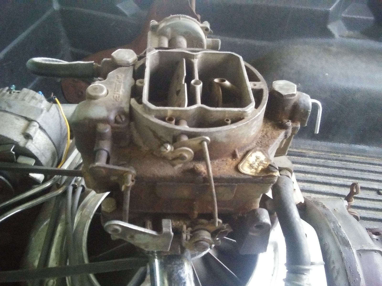

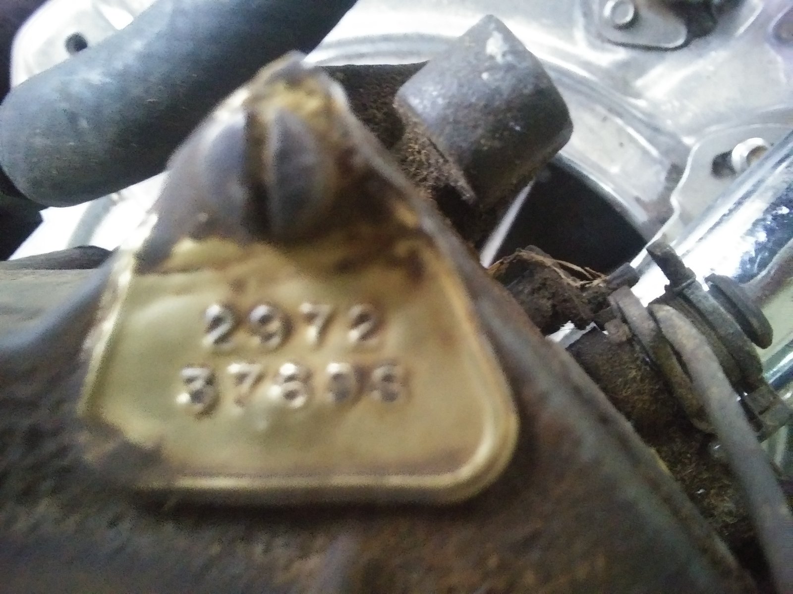

    I bought a Corvair motor that was modified to run in a VW trike. It was originally a 180 HP Turbo motor but had a Carter WCFB 4v carb installed during the swap. The tag reads 2972 and 3769S . Anybody know what this came on or fits ? TIA

    3769S indicates it’s a 57-61 Chevrolet. Linkage does not have the rubber bushing style of later carbs but definitely Chevrolet.

    That is a service replacement carb for a 55 Chev 265. It is the only Chevrolet WCFB that has the cast riser on the base for a bellcrank. It is rated at approx 337 cfm, it is a good little carb for a small c.i. engine.

    Every part Chevrolet made from 1953 through 1967 is an ultra-rare Corvette piece;) Just ask all of the Ebay vendors :p
    Saltracer nailed the answer; service replacement for the 1955 265 CID only.

    I recall reading an article in a magazine years ago that suggested this carburetor for modified Corvair engines. I believe that Carter released it as a 265 service unit in the mid 1960s.

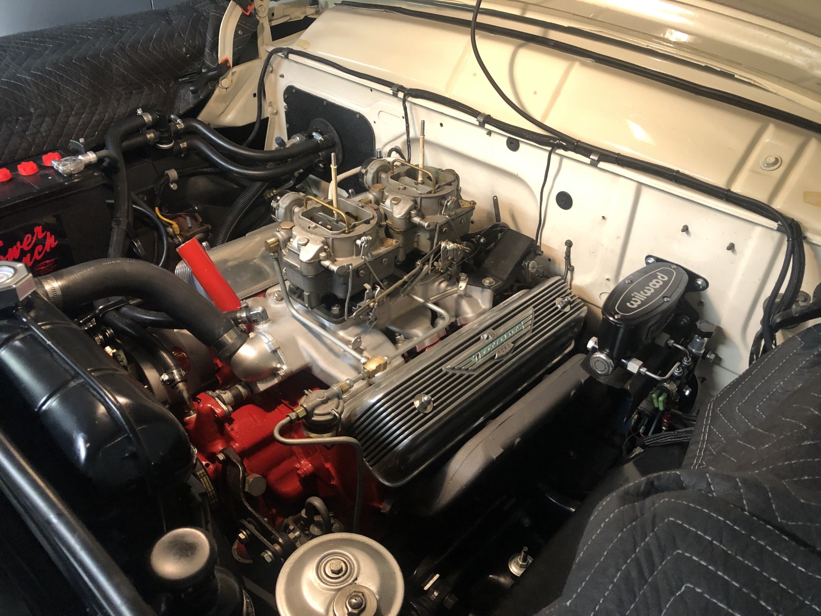

    WCFB’s are to be used….best in pairs on any engine. These 2 were being used when a 265 was still on the drawing board just not on this engine. 27A1BD01-D2E7-4DB9-AE55-B17A16B3AAD4.jpeg
