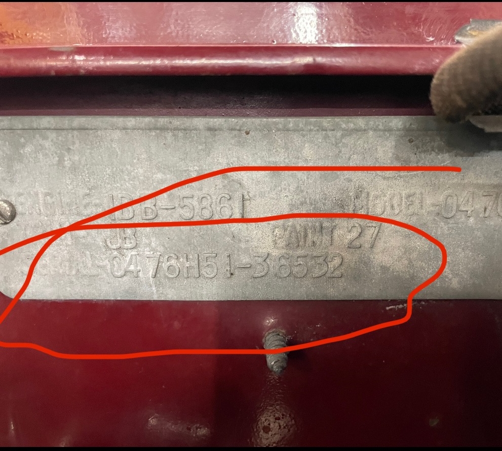

    So I've been trying to find a place that could help me with information on cars that pre-date Elvis becoming a household name, and this forum came up first on the search. So wondered if anyone could help me translate this data plate and see if it matches a car that I'm looking at.
    SO I've found a '51 Ford Custom convertible for sale nearby. with the original "three on the three" and the 239 cid Flathead. I'm mainly trying to see if the data plate matches what's on there. I've included it as a picture for review.
    Also this is apparently a Canadian car, which may mean it may be a Meteor model...or not.

    Doesn't appear to be a Meteor, but just a regular American version. I'm not sure if the vin # at that time period tells you more than just the production number. What info are you trying to get?

    Canadian numbers are usually different than US numbers, and pretty much all the info online is for US numbers. No wonder it doesn't make sense.

    As you can see, that 'data plate' is attached with screws, its not original to that car. I have 8 49-51 Ford cars and none have a plate like that. Ask the seller what that plate is.

    The main thing is does the serial number match the ***le? HRP

    he has to find the real serial number first

    Meteor has a different grille.

  14. So according to them it is, the numbers the same as it is on the ***le. I'll bet money that the folks at the MTO just saw that and ran with it. I've found them ot be pretty unknowing of anything pre 17 digit VIN.
    Where would the VIN be other then there? I'm having a look at it on Sunday so figure it'd be good to confirm

    since you have a plate with your serial number that matches the ***le, go with it. In my 55 years of driving antique cars (only! no modern cars) I have never had anyone look at my serial number

    The cars actual serial number should be stamped on the diagonal brace in front of the right side of the radiator if it's US production.
    I'd check that first.

  17. Sadly it doesn't. Like the numbers are all wrong, which is really weird. Like on a page that someone linked earlier, it should start with something like 1B..... but instead its a 47
  18. Go directly to the Frame as mentioned. There is a diagional brace with the Ford factory numbers stamped on it. If they don't match the ***le, I'd be nervous. I can get you a photo if needed.

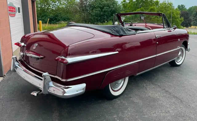

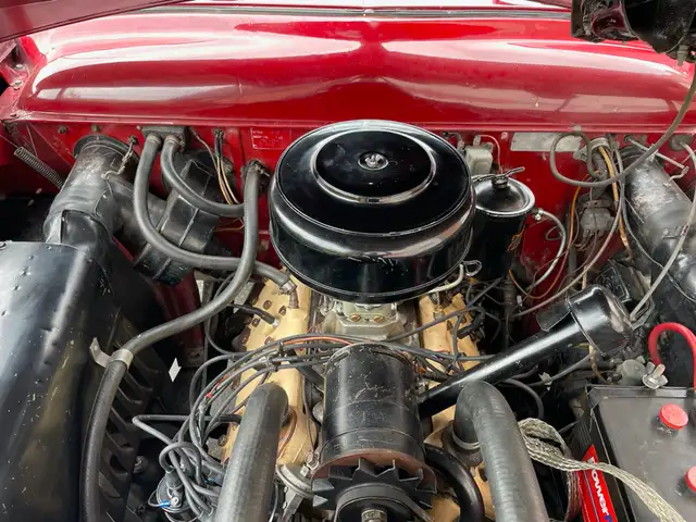

  20. I noticed that the maroon doesn't match the red. It looks like the exterior was repainted.
  21. I'd greatly appreciate it. My experience is more with 60's cars so any help would be appreciated.
    Oh? Could you Identify where? I'm concerned I've missed something obvious.
  22. The interior and engine bay are red. The exterior is maroon.
    theconvertibleguy likes this.

    Like some people said have the seller or you go and check on the top of the frame rail for the stamped VIN, then compare to the ***le. Otherwise start walking away slowly.
    stamped VIN are on all Ford some on the left some of the right dep on truck or car.
    Also note that in some states if you are transferring it in, they want to see the VIN in two spots. some office in CA do this. but the rear deal is just the main VIN on the frame.
    UPDATE the INTERNET says a bit differently, check the opposite of these circles.
    apparently "For 1948-51 Fords the VIN plate is located on the glove box door and on the left side of the frame near the steering gear mounting bracket. The information on the rating plate is the VIN number."

    Sorry, bad information here.
    1. As mentioned before, the only easily seen serial number is on the diagonal brace in front of the radiator on the right side on '51 p***enger cars.
    2. The "UPDATE" quoted pertains only to '48-'51 pickup trucks, NOT to p***enger cars.
    Please don't post clearly erroneous information on thhreads where people are trying to determine the authenticity of their (potential) purchases.
