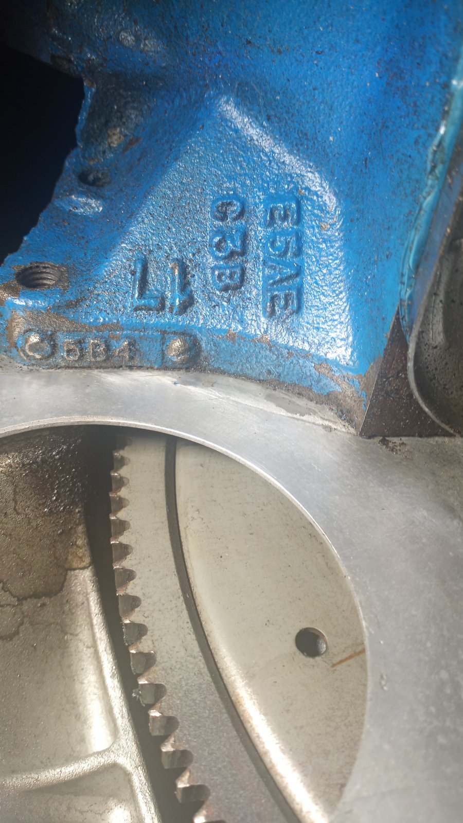

  5. orangedog
    Joined: Jun 9, 2020
    Posts: 184
    orangedog
    The numbers above the starter are hard to see with every thing in place. This is mine with the starter removed. 1985. 20240810_145641.jpg
    warhorseracing and Hybrid Vigor like this.
  6. Hybrid Vigor
    Joined: Sep 16, 2020
    Posts: 54
    Hybrid Vigor
    Looks like I'm going to be pulling the starter and exhaust manifold over there. Thanks for the pic that helps a lot.

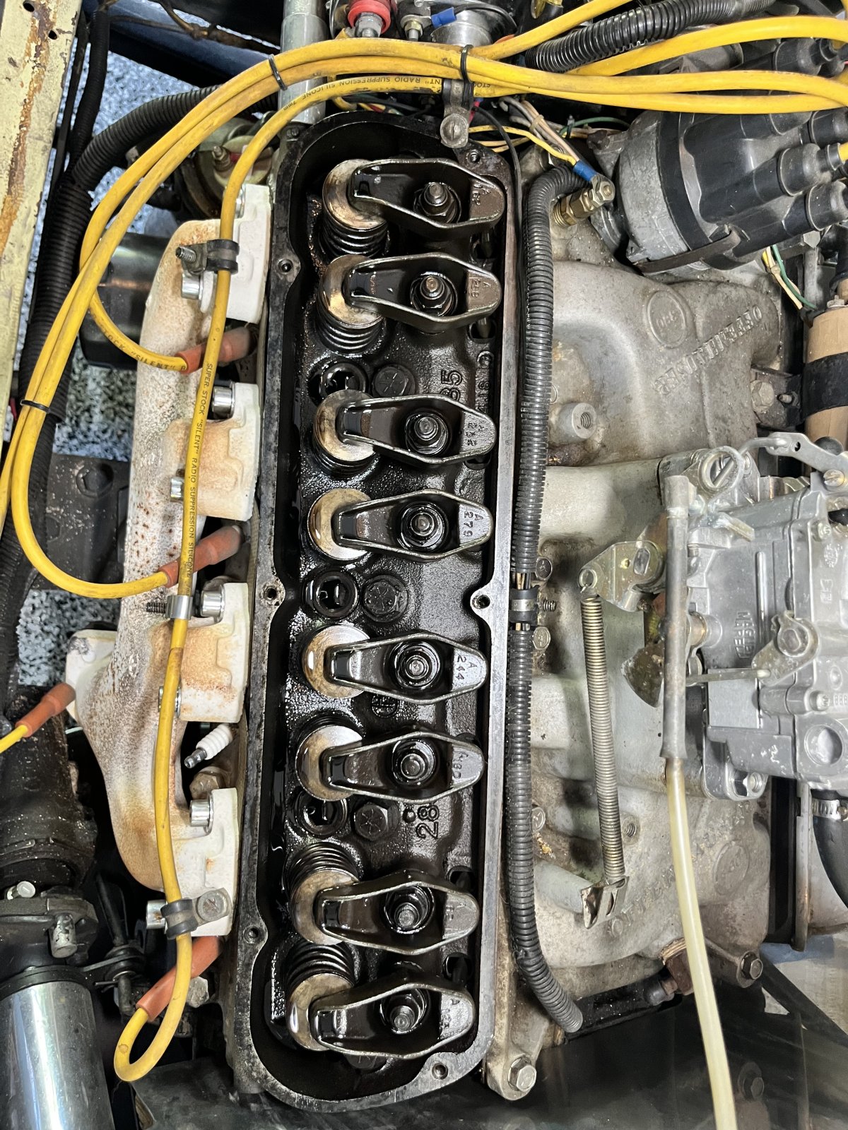

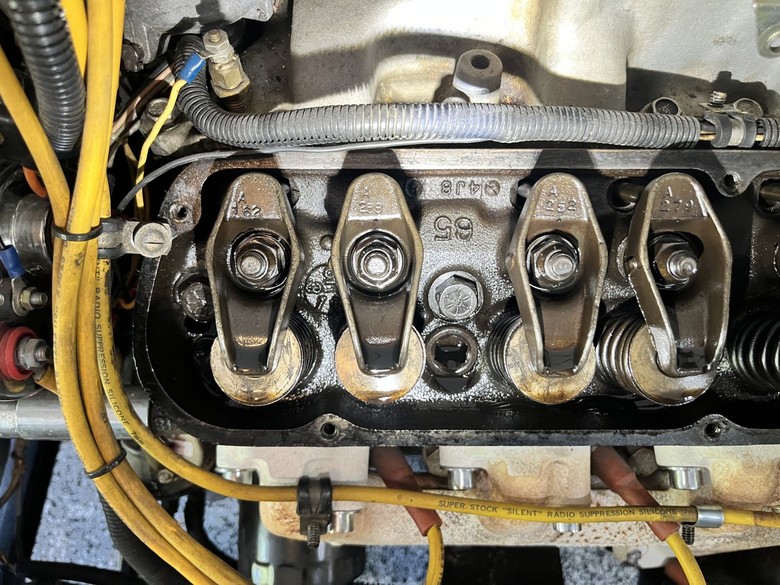

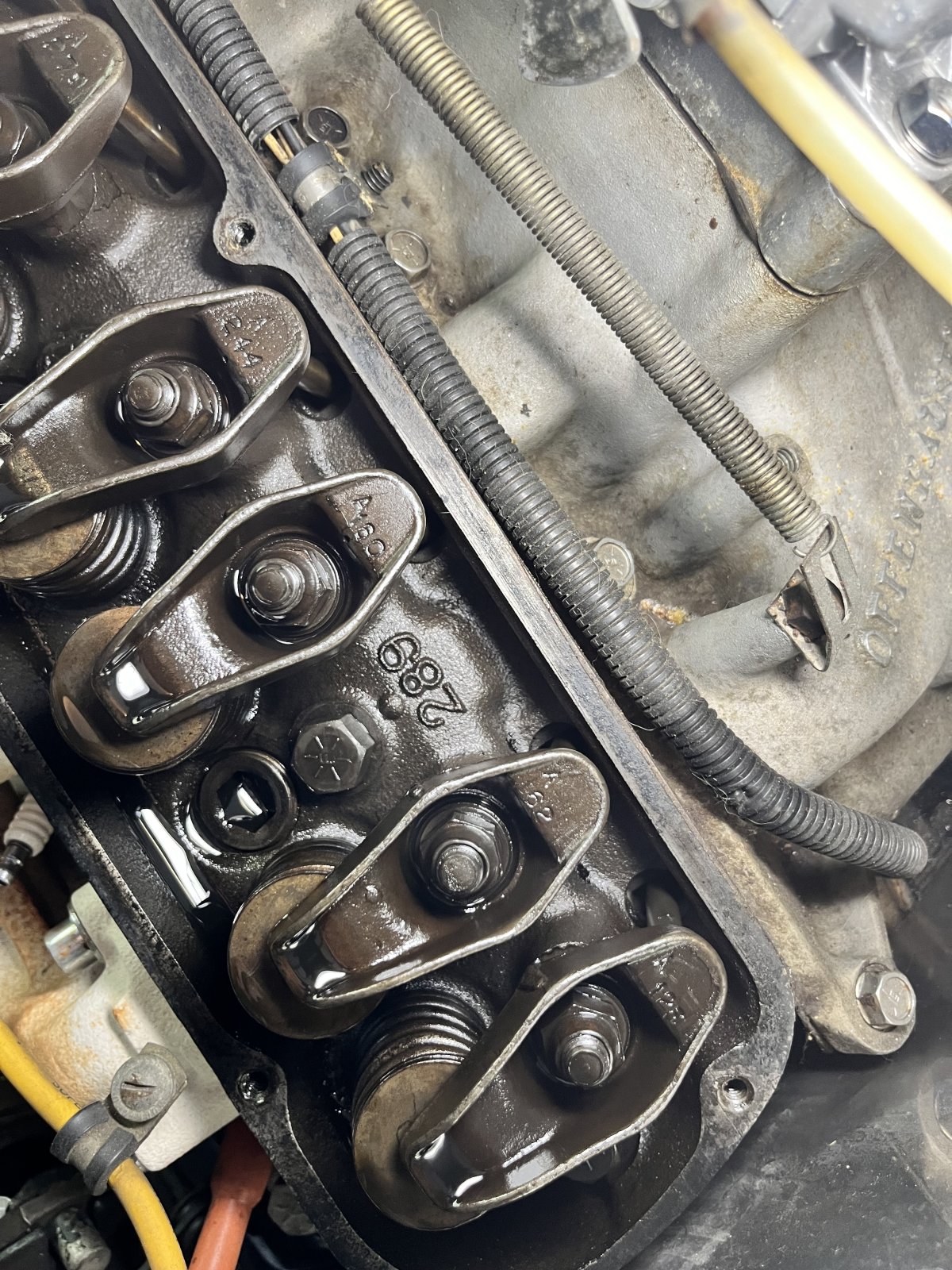

    A lot of good info in there. Ok so it’s a 6 bolt bell housing with 5/8” bolt heads. The filter on it is a Wix 51068 and the spark plug wires are 7mm. None of my spark plug sockets were large enough to get the spark plugs off. I did take the left valve cover off and got this photo.

    That’s next though based on the heads looks like it’s a 65 289. I wish I could talk to the previous owner but he died and his sister didn’t know anything about the car.

  16. RmK57
    Joined: Dec 31, 2008
    Posts: 3,083
    RmK57
    The 4J8 is a date code.
    Year=1964
    Month= September
    Day= 8th day
    I’d keep the little 289 in it if it were mine. Re-dress it period correct for 1964 and enjoy it.

  17. Flatrod17
    Joined: Apr 25, 2017
    Posts: 688
    Flatrod17
    Yes, looks to be a 1965 289. On the drivers side of the block, just in front of the head is a small pad, it will have numbers and letters on it. That will be the date the engine was assembled. It would decode similar to RmK57's break down.

    Joined: Aug 31, 2008
    Posts: 1,644
    deucemac
    E5AE would be 1985, the first letter is the decade (started in the 50's with a B)
