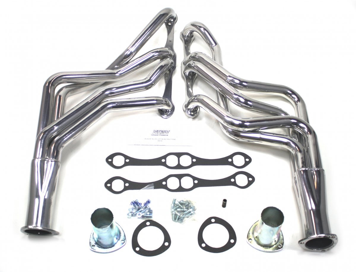

    This is a Patriot Header (H8096-1 in Ceramic, H8096-B in Black) that is made Specifically for the 77-87 G metric ch***is, which is what your 79 Chevelle would be. These are designed to work with most brands of angle plug heads, so as long as they used the original motor mount location you should be good to go.
