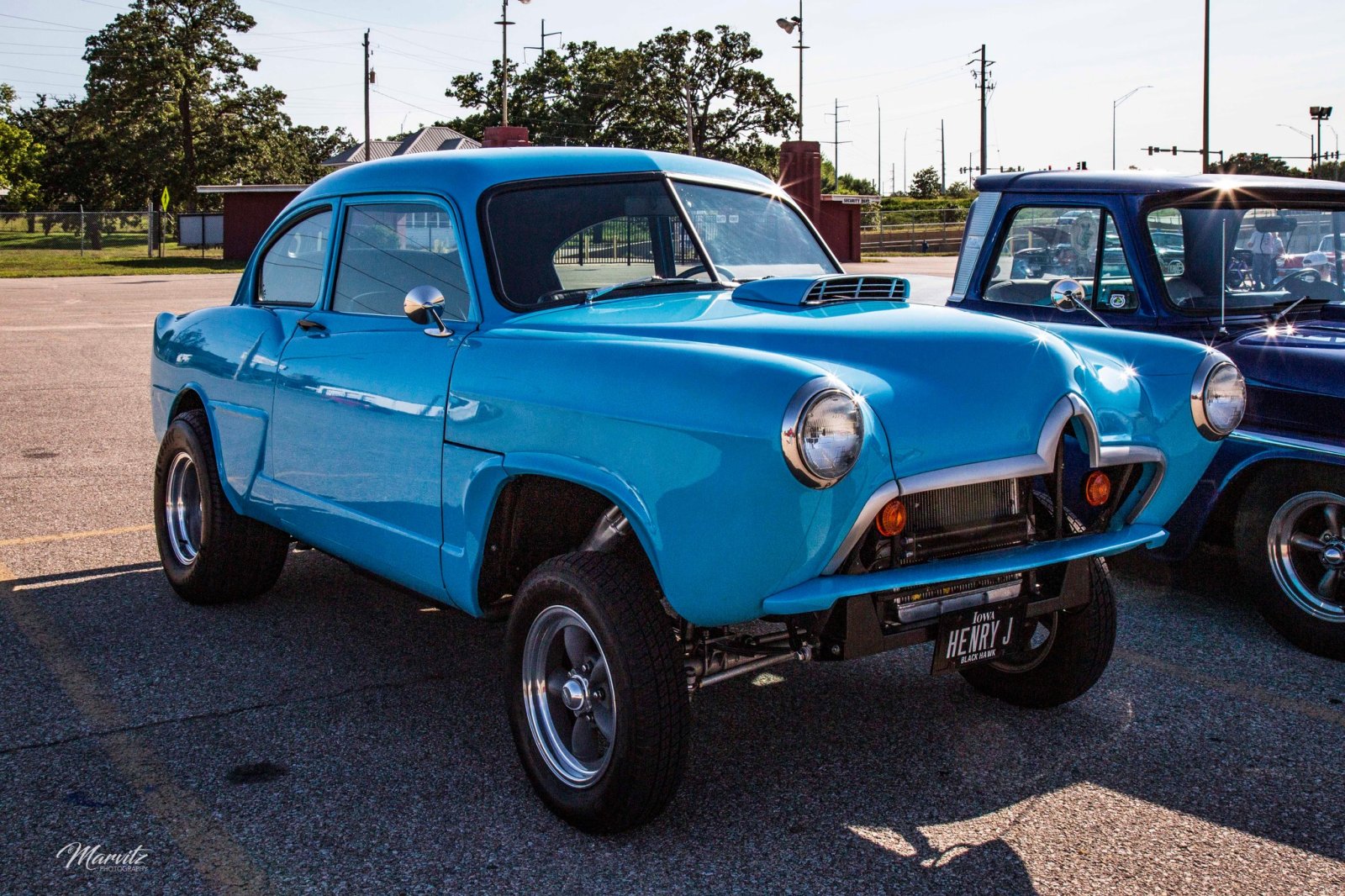

    Mine is fine with a 327. I did add some extra leaves to the rear springs.

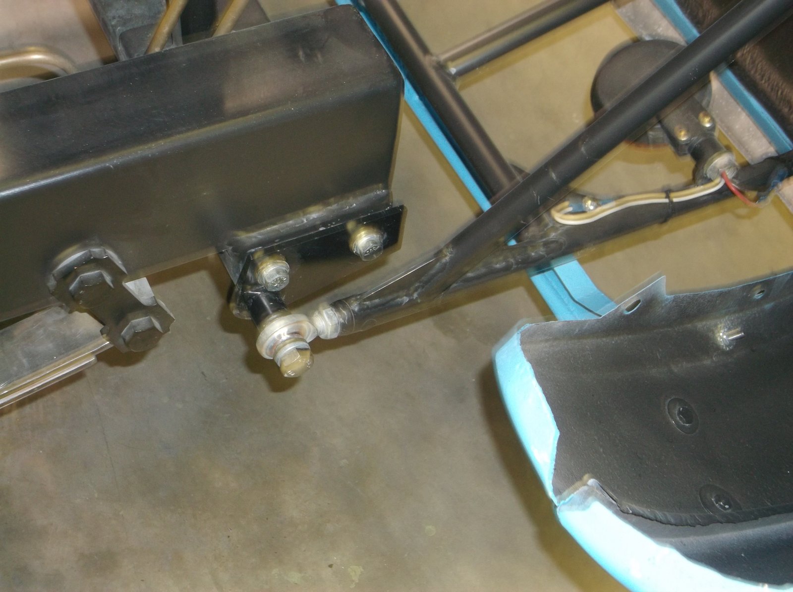

    I cut mine right above the factory brace. Since the cut line is above the pivot point, it doesn't need to slide out before tilting. I used 1/2" heim joints fore hinges, very smooth moving.
