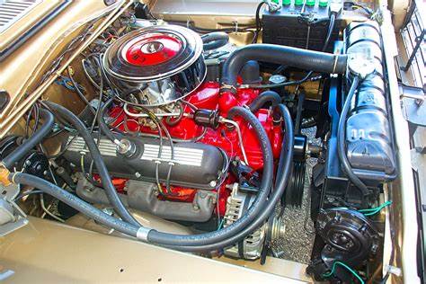

    by 64, they had 273 SBM V8s. they were the same basic ch***is, but had some changes to fit.
    67 was an updated design, which was modified in 68 for a bit more strength and room.
    OP hasn't said which year, but even 64-66 which had V8s are not easily able to handle increased HP with headers, more power (heat) and having a clutch just adds more stuff in the same area.
    Here's a 65 Dart GT (HAMB correct, barely) Tight, especially down around the frame rails. One of the things people that modify don't like is that on Mopars, the steering, starter and the clutch if equipped all are on the driver's side.
    It can be considered roughly the same as similar Novas or Falcons.
