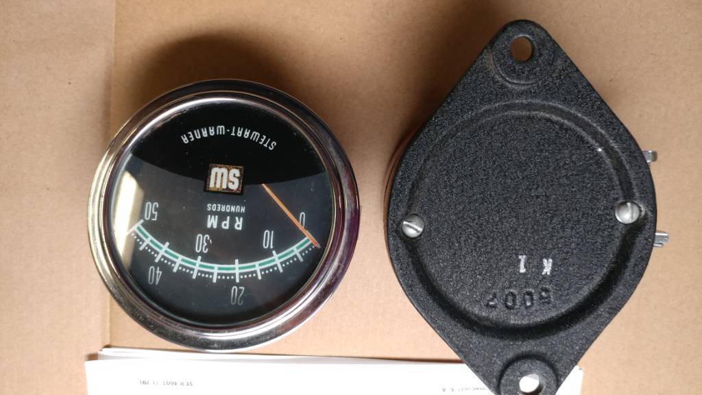

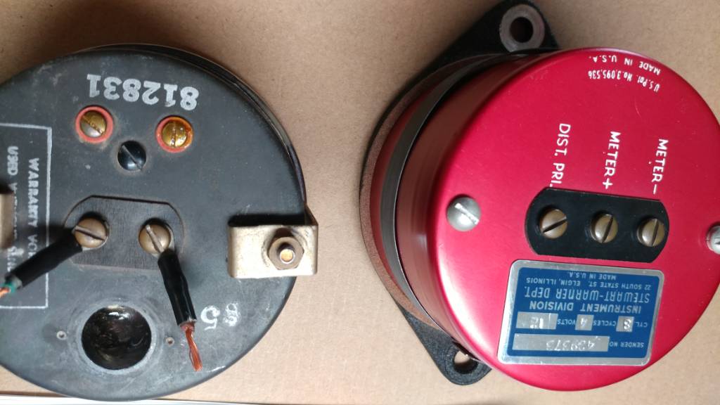

    Hey guys. I have a similar green line and 0410171600.jpg a red box sender. Do you have any wiring diagrams? 0410171600a.jpg

  13. thought I would toss up a photo or two of an old SW green stripe I have showing the wiring and how the gold box connects, click on the pictures to see em bigger

    The post just below yours shows the + and - connection points between sender and tach. Somehow yours must have been worn or wiped away. Bad thing is that sender most likely an early version with obsolete batteries. At least all the ones I've seen without the removable adjuster plug on top did.
