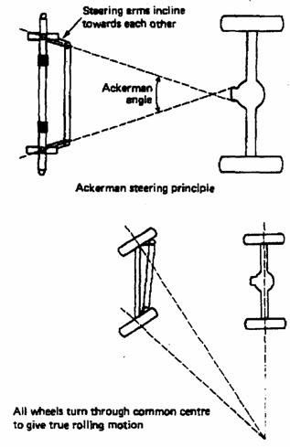

  23. [​IMG][​IMG]
    Thats about as basic as it gets for front suspension design, ie. "mkII mustang" or any race car.
    First point to make is; look at the angles front on. On a lowered shoebox your bottom arm will be close to level. same goes for your upper arm pointing up a bit. on all the road/track cars this about the standard. your steering arm should be angled as the diagram describes.
    Two question marks remains on a shoebox about the rearward angled arms. And the built-in ackermans angle on the steering arm.
    First, the rearward angle, in my opinion point "C" would be the center of the bottom arm shaft (in terms of width from the cars centerline). Thats all.
    The stock steering arm setup is rearward of paralell. as i mentioned before this would give additional toe out in a turn, however the idler and pitman arms push everything forward as you turn left to right. This lengthens the setup causing toe in.
    Its clearly Fords atempt to compromise, the overall effects will cancel each other out. (stock steering)
    So what does all this mean?
    1. The length of your steering arm needs to be from point "C" as above, to point Z which on the ford is the king-pin (not outer ball joint)
    2. ackermans (turning toe out) is built into your steering arm/kingpin setup, so mount your rack and arms parallel from a birds eye view (straight across).
    3. Height wise, simply bolt up your outer ball joints and refer to above diagram.
    4. As for the spacing between the inner joints, firstly allign both wheels perfectly parallel. Then how I would build Stefans bracket would be determined by where the inner rod ends ended up after following 1,2 and 3.
    After putting plenty of thought into it I think Stefans setup looks pretty damn good :)
    If i dont "clip" my shoebox this is what ill do.
