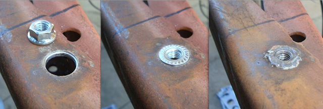

    Use the nuts with the washer built-in (flange nut).
    With a drill the size of the flange countersink the frame. Turn the nut upside down ( flange up ) Weld the nut to the frame. This should hold it.

    I watched a friend of my dads install a bunch of the nuts 52poncho described in a custom frame. He drilled a hole in the top rail of a boxed frame, the hole was just big enough to flush fit the nut flange in the frame, ran a bolt into the nut to give him something to hold on to, turned the nut upside down, lowered it into the new hole until the flange was flush with the top frame rail surface, tacked it all the way around at the edge, ground it smooth and hit it with a rattle can

    Go and buy yourself some flanged nuts the size thread you need. Drill a hole in the frame just large enough for the hex part to drop in. Now weld around the flange and your home free. This will result in the threaded surface to be a bit higher than the surrounding frame but if your unwilling to cut an access hole in the frame you have little choice A thick gasket cut to fit over the raised area could provide some filler if the gap between the part and the frame is unacceptable.

    Just drill the frame to insert the nut, use a bolt to hold it into position and weld. This works well. Fab32 uses this way also as he described. Not that difficult. :cool:
    Notice the countersink in the first photo.

    what 52poncho said..get something like those..drill a hole in the top of the frame...hold it with a bolt to tack it on..then burn it in good.

    Personally, with the frame just in primer...I'd go the welded nut way that has been mentioned already by several people.

    If you use a stick welder use a small 6011 rod otherwise a MIG works great but a TIG is best. Sorry i didn't explain it better to begin with, but a picture is a thousand words. Give us a picture of how they turned out. Good luck! :cool:
