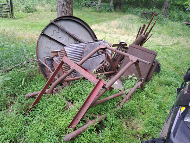

  11. my phone was dead by the time i got to the truck, but its completely covered in dirt. heres a couple pictures of other things to give you an idea of its condition.
    not buying it, im fixing it for them. it has to be this truck.

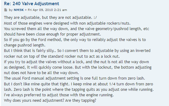

    Adjusting the valves. If it is a '61-'64 and it has the original 6 cylinder, it's a 223 cubic inch engine with solid lifters. If it's a '65, it will have the 240 inch engine. The following describes how to set valve lash on either engine.
    Valve adjustment for 223.
    wraymen and The_Cat_Of_Ages like this.
