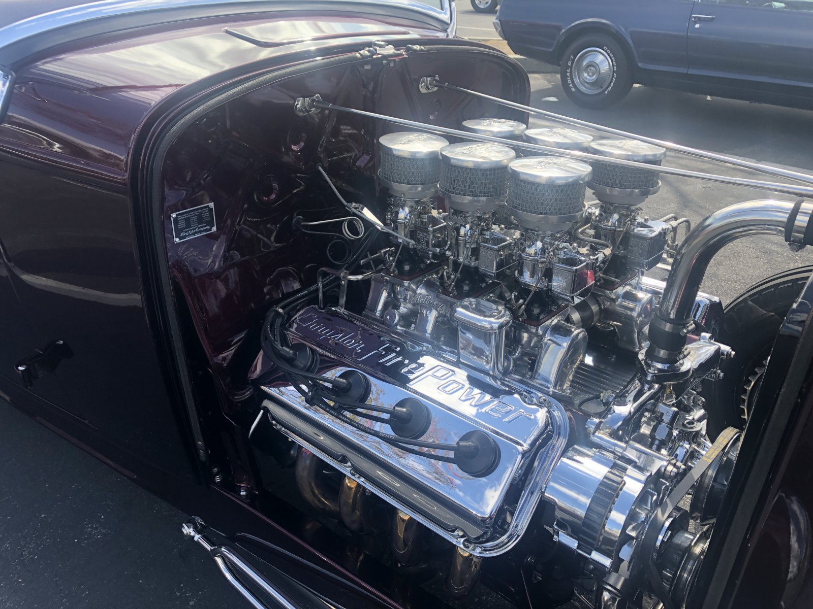

    Really nice 6-2’s on an Edelbrock manifold. Fuel lines were the best I’ve seen. They are progressive and run on the center 2. According to the owner the engine has 4000+ miles with very minor tweaks. IMG_5636.jpeg IMG_5635.jpeg
    Just Gary and rod1 like this.
