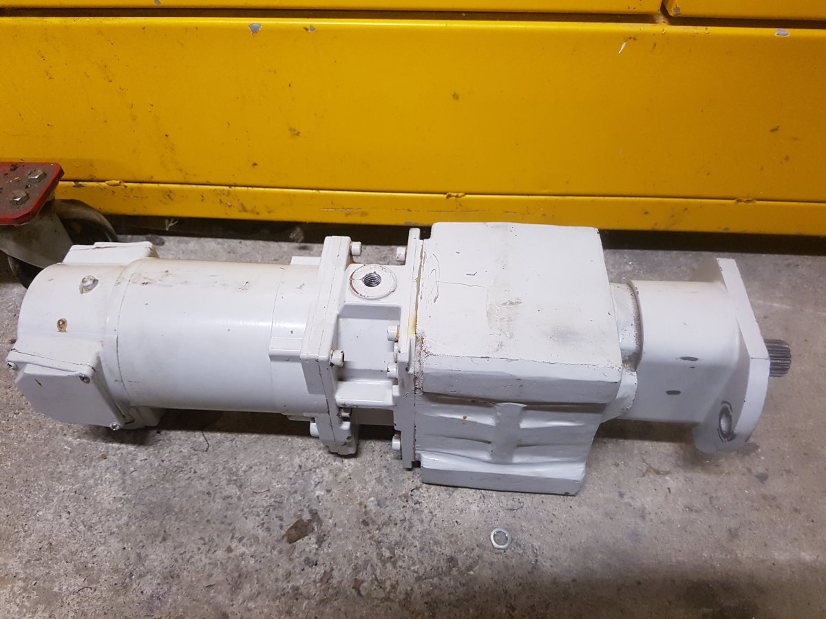

    Well I'm nearly back on target. I got side tracked making a bead roller so I could do the floors then I decided to finished the English wheel I started 7 years ago.
    I had trouble finding a decent power source that could be controlled easily and that had heaps of torque.
    I found a 24 volt solar tracker motor with an RPM of 5 and a torque rating of 110Nm.
    ****loads for what I want.

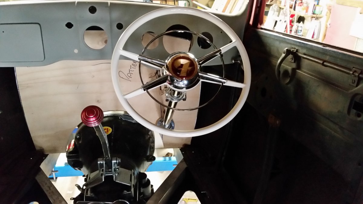

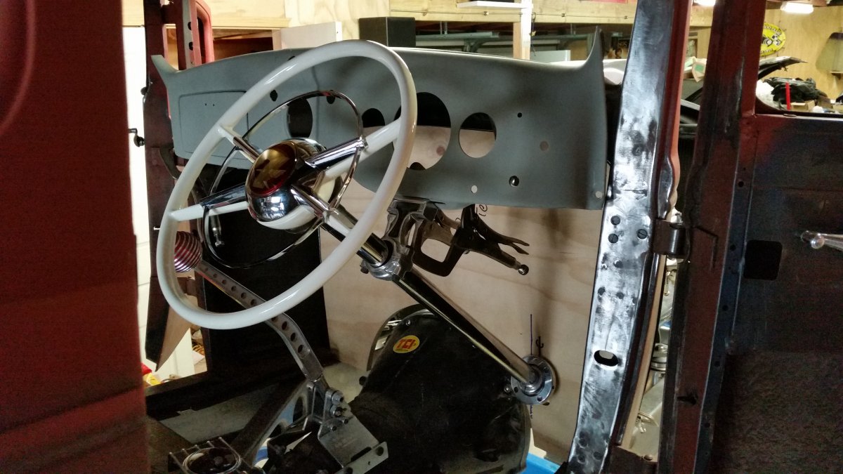

    Did trial fit with steering column and steering wheel and dash, As I am the opposite to a slim midget I will make the steering column swing away like my 62 Thunderbirds steering does. I knew it was going to be tight but those Model A doors are not very big and there's not much room between that large steering wheel and the B pillar.
    The plywood firewall is just there for a pattern I have one already to fit made from 1.6 mild steel 20160105_141909.jpg 20160105_141935.jpg 20160105_142023.jpg sheet with bead roller work on it.
