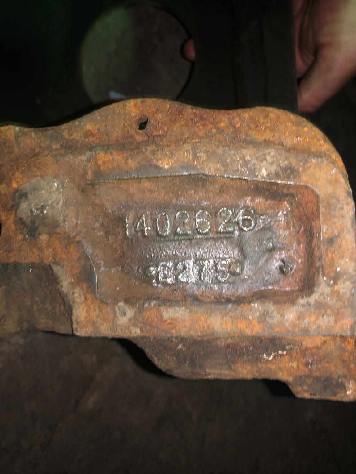

    Does anyone know what transmission fits this Chrysler Hemi bellhosing? I would like to use this with my 331 hemi. IMG954560.jpg IMG954559.jpg

    The early bells used a couple of different transmissions based on the application. It 'looks' like the usual 3-speed that is pretty much a one-off in terms of interchangeability. Also, they had an odd shift arrangement that does not lend itself to aftermarket shifters.
    Depending on the depth of your bell you may well be able to adapt an A-833 as they have the longest input shaft.
