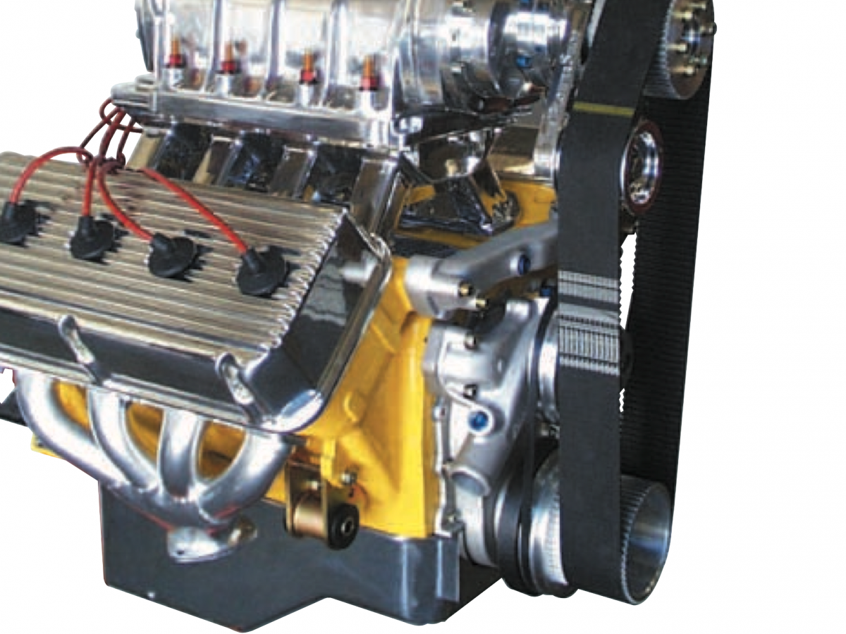

    This would be the correct way to run the heater hoses. If you look closely you will see the hot side comes out of the head between the intake ports and the cold side returns to the water pump inlet. The byp*** is hooked up correctly as it would be on a stock hemi water pump.
    The problem arises when you install a blower then there is not a proper place to pull water from. A couple options are to have a tee with one side going to the heater and the other to the top of the water pump for the byp***. If you don't get enough heat out of that you might have to put a restrictor in the byp*** to slow the flow. Another option would be to pull water from the back of the head for the heater.

    I just got done measuring my friends 392 and the measurement from the block to the center of the water pump ****** is 3" and that puts it forward of the crossover. The best option is to make it like the original PAW unit and sett the byp*** up like the picture that HemiDeuce posted. For a heater on the blower engine one could use the back of the left head by installing the adapter that HH sells for their crossover and installing a 90 degree hose fitting in it. Or just make one out of 3/8" plate and tap it for pipe thread.

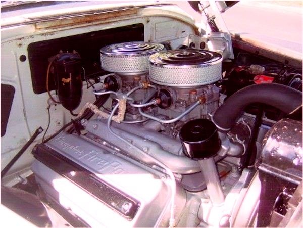

    I see that the 331 head's have no provision for the crossover so how did the factory deal with that?
  8. Went over that in detail other thread. Wet intake manifold with integrated thermostat housing. From the factory Most were 2bbls. Some 2x1 some 2x2 One year only 1954 4bbl. After market Edmunds had 2x4 small runner for 51-53 and large runner 1954
    There's more but they are wet manifolds.

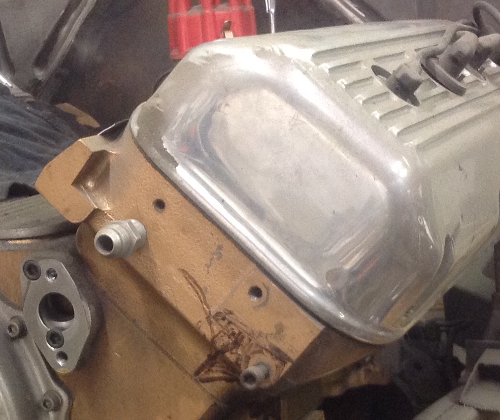

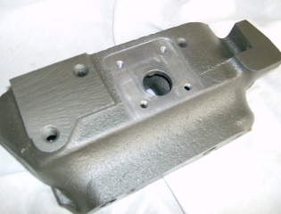

  24. These pics aren't for a blower application necessarily, just food for thought.
    However there are plenty of head that could become usabl.
    Here's a part that TR waters used to make to get water from the front of truck heads. You can tell the truck heads by no water outlet, the accessory mounting face and the big lug
    This Required the head to be drilled and milled then the pipe thread adapter bolted on with O ring seal.
    That above part allows enough tapered threads to be safe VS just tapping the thin casting like this. There isn't really enough meat there for tapered pipe threads.

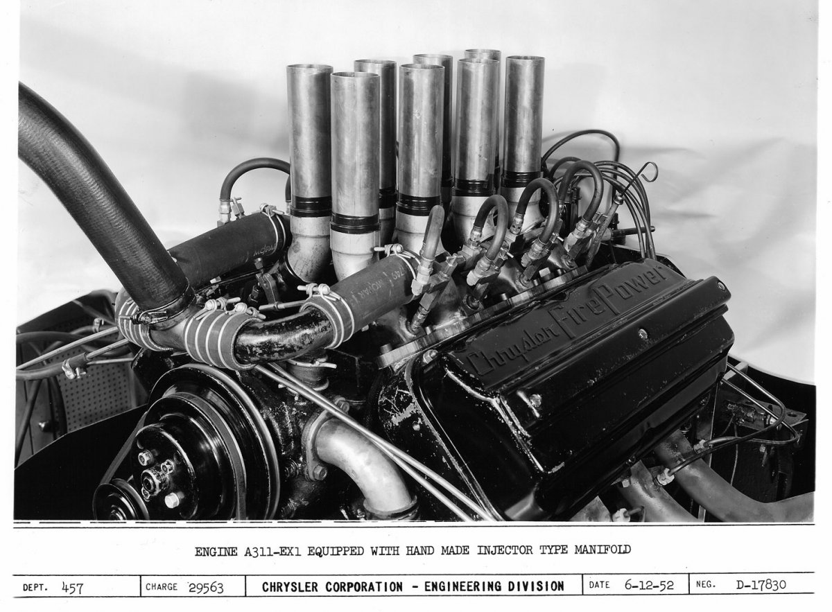

    Here's how B*** got water out of a 331
    Here's some crazy stuff Chrysler did
