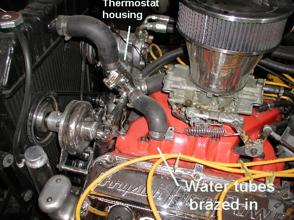

    I had a related problem with my early 331 hemi. those heads of course don't have the cl***ic hemi crossover, they have the thermostat built into the intake manifold similar to the SBC. Unfortunately those manifolds mostly are 2bbl ones, not amenable to performance application to say the least. A 354 or 392 4-bbl manifold will bolt up to the 331 heads but you lose the thermostat/water transfer function. I solved the problem by using a 354 manifold wit the front water P***over holes drilled out and short stubs of 1 1/2" steel pipe brazed into them. Then I built a thermostat module that is attached with short sections of rubber hose. Problem solved!
    Here is what I needed but they are rarer than hen's teeth!
    This is what is commonly available
    I drilled out the carb holes to adapt a modern big carb.
    I run a Holley 3bbl!

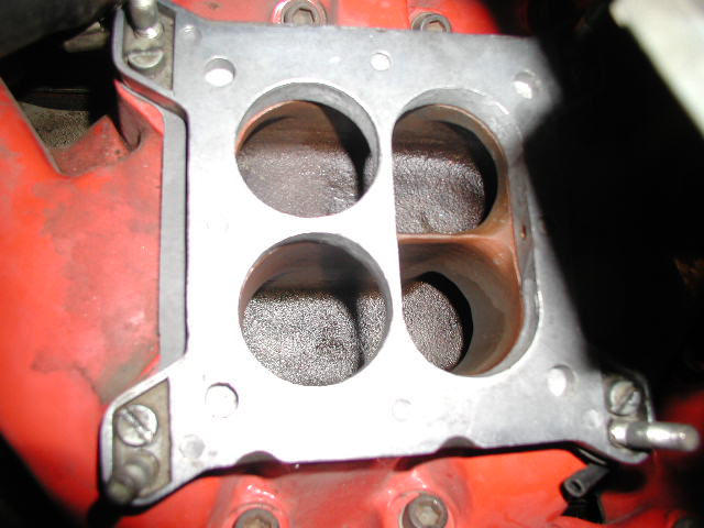

    Here is the same manifold with the crossover. Works like a champ.

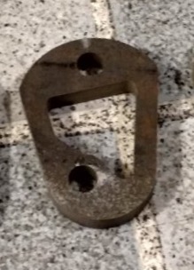

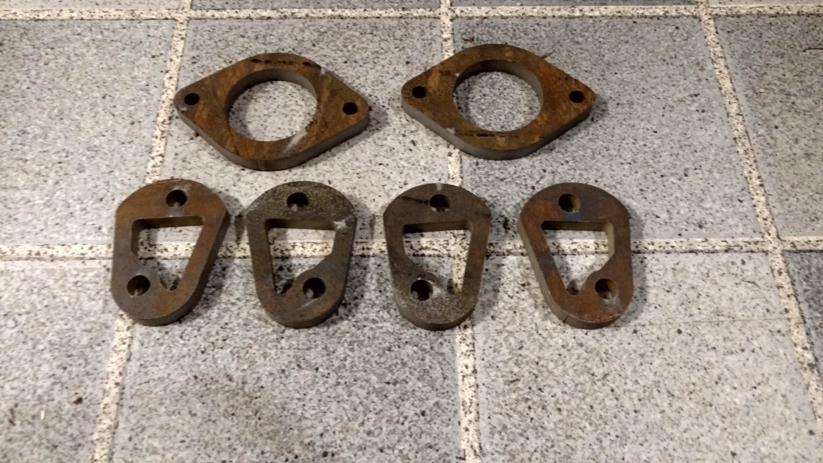

    I sent the DXF files to the water jet place to have a couple sets of flanges cut out. In the meantime I can make a jig to hold the ends in place while I weld it together. This will be a couple steel welded units for testing the fit.

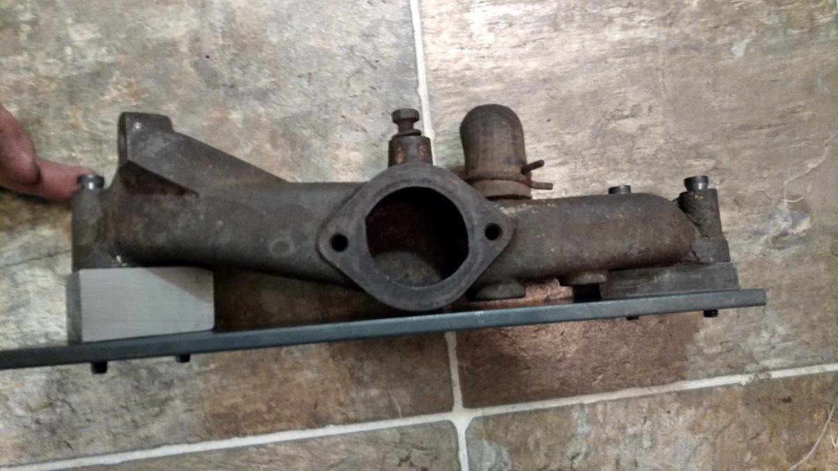

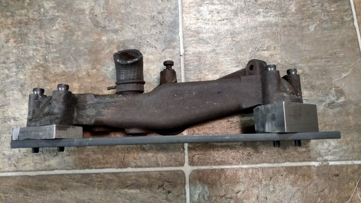

    I had my machinest make a jig plate off of the original crossover. When I get the part's from the water jet guys I can bolt the part's to the plate and weld them together. I will be making the cross tube out of 1-1/2" box tubing. Here are a couple pictures.

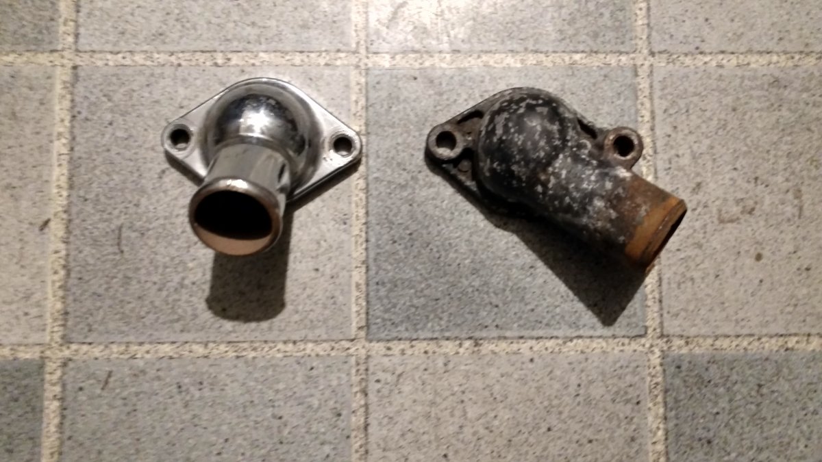

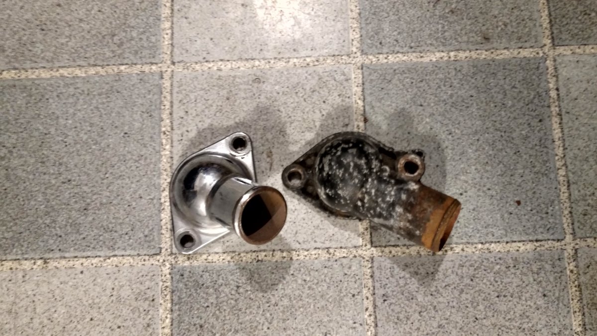

    I picked up the water jet parts tonight and started to mock up the water neck. In doing that I noticed that the water neck that the PAW crossover used is a straight 90 degree. In the pictures below you will see that the same angle can be achieved by using a stock style GM water neck. So I propose to you that the bolt holes be placed parallel to the face of the block as this will achieve the angle and make the pattern easier to make. The second picture shows the orientation of the PAW unit in chrome and the new orientation that I want to do with the stock GM water neck. Please let me know what you think.
    IMG_20170131_180800126_HDR.jpg IMG_20170131_182531422_HDR.jpg IMG_20170131_182349126_HDR.jpg

    I have seen about a good dozen variations of water neck in the aftermarket, including ones the swivel.
    I think that if the bolt holes are parallel tot he face of the block, it will be fine. There are myriad solutions for any desired angle.

  15. Don't count on using a swivel housing because they are almost guaranteed to leak.
    I think it might be OK to set the themostat holes straight???
    The majority of these issues seem to be only important when a blower is in play.

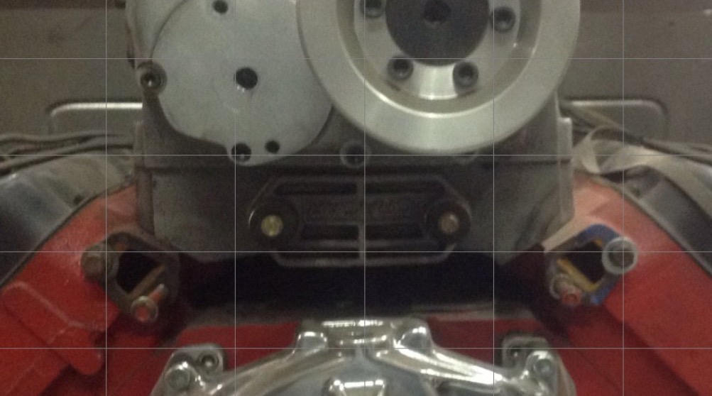

    The bolt holes would go into water, I believe they aren't into water on the paw unit.
    It will push the center line of the housing over to the p***enger side a bit but how much exactly.
    If I look at the below picture, rotating the T stat would put the bolt hole into the mess of casting ? And that would result in the need to move it enough to get the bolt hole out of it?
    On the paw unit, it appears the used the positioning in order to move the Tstat every possible iota over to the drivers side.
    How far over would it move ?
    These vertical grid lines are about 3-1/2" on center

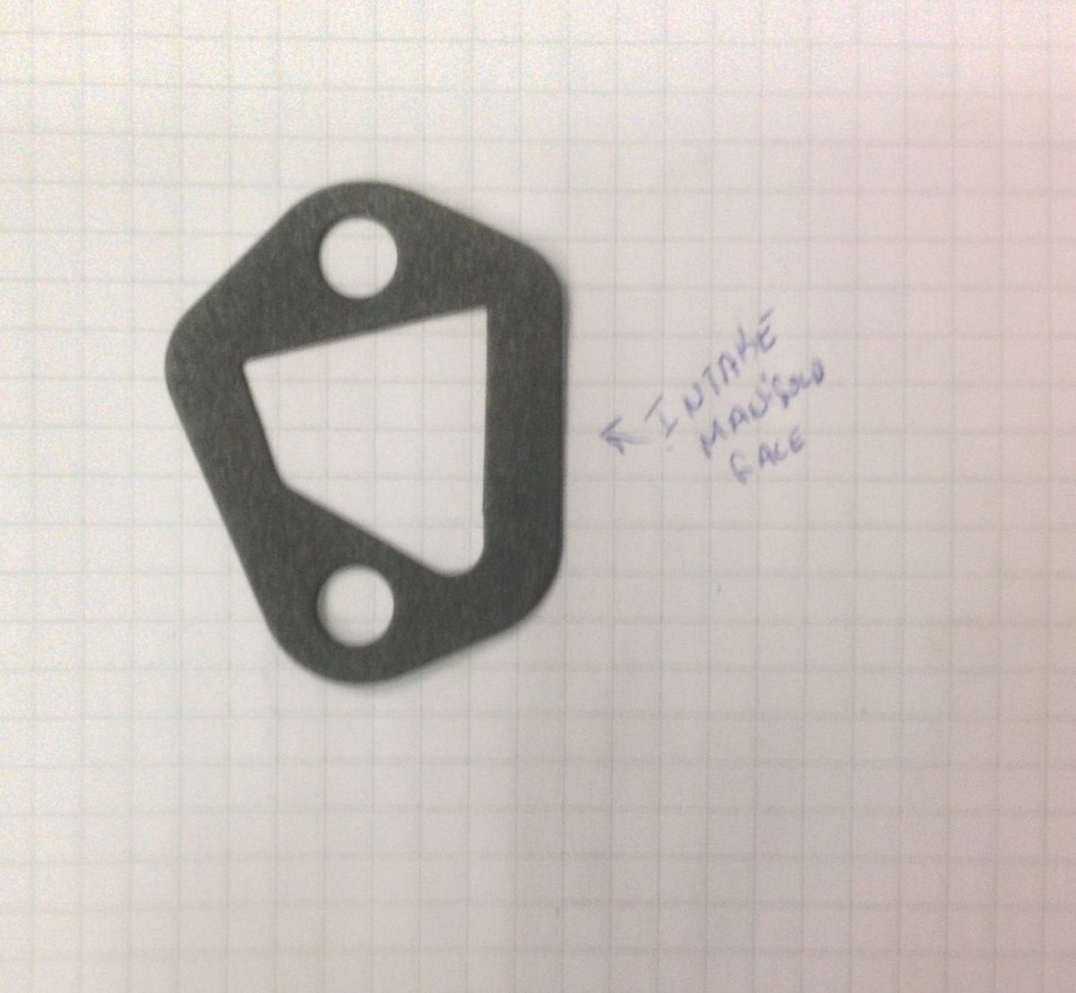

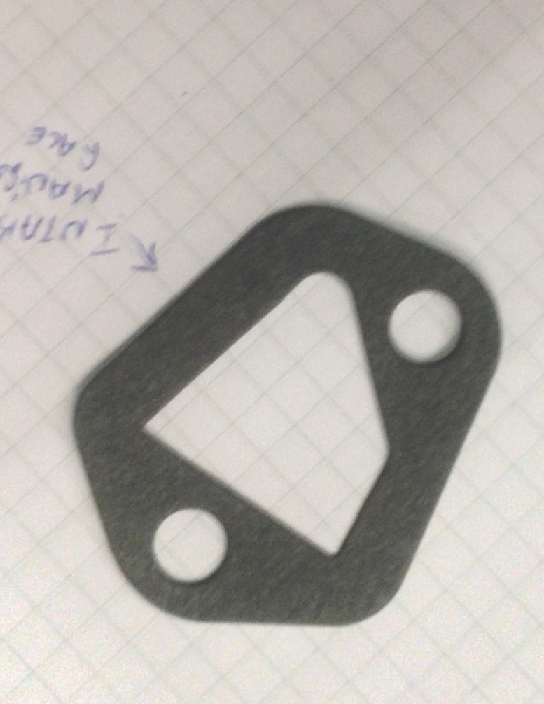

    The flanges you had cut appear to be quite different than a Chrysler gasket,
    the gasket is photographed on 1/4" @ 4 squares = 1" graph paper
    And it follows the head's profile shape perfectly but about 1/32" larger on all sides.

  24. As you know I've been reading along on this and will need one also. My question is why not move the T stat housing outboard or just over the Drive side head hole? The issue seems to be Hose clearance to the drive belt. Your casting a complete new unit so a flat spot over or past instead of inboard of the head mount bolt holes, what would it matter?

  28. I must be missing something here?
    The bosses are there and out of the way and usable if so inclined. The edge of the t stat housing runs parallel with the bolts going into the head. One t stat housing bolt is behind and the other ahead of the water p***age.
    ^^^ that's what I get from looking at the pics^^^

  29. 55willys
    Joined: Dec 7, 2012
    Posts: 1,715
    55willys
    IMG_20170131_182531422_HDR.jpg image.png The casting pattern would be easier if they are straight across. In this picture you will see the orientation of the PAW unit on the left and my design on the right.
