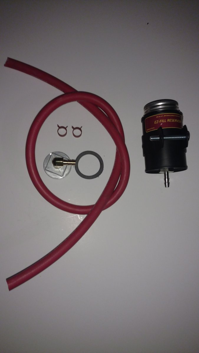

    I am slammed with work and suddenly my remote brake reservoir kits are selling. Trying to restock parts to fill orders. This is the 1-1/4" master cylinder cap pictured but I offer 1-5/8" and 3/4-18 caps as well. IMG_20170213_212019707.jpg
