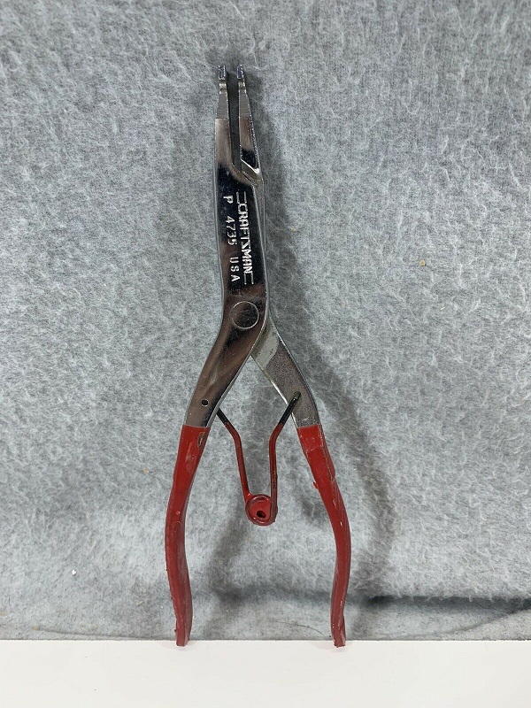

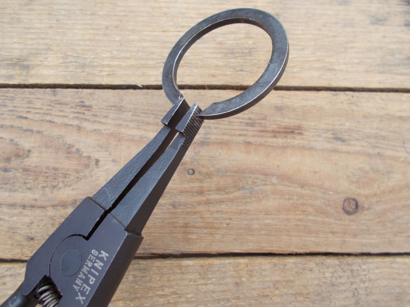

    As far as removing the oil pump intermediate shaft, is the 354 shaft similar at all to what Mopar used in 318s, 340s and so on? I remember years ago using a pair of external snap ring pliers like you might use on an automatic trans rebuild. They need to have flat tips as pictured below that will fit in the slot in the end of the shaft and be fairly long and narrow. Drop them down into the the slot, give them a good squeeze and turn them a bit while lifting out the shaft.

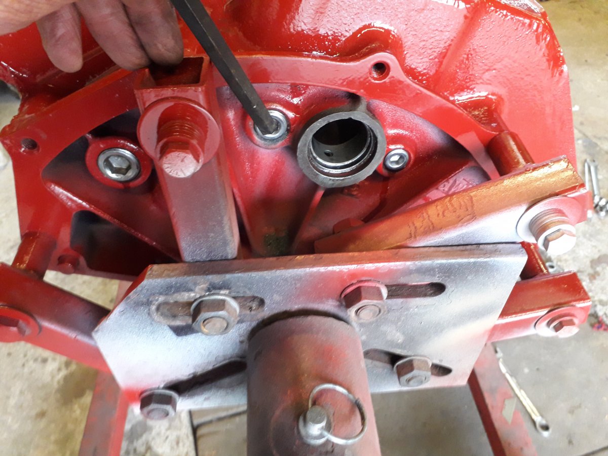

    It's this plug 20180508_111037.jpg that caused the problem not the inside one.

    Oh, OK. Hmmmm, loc***e or a dab of J B Weld I guess
    junkyardgenius likes this.

    Interesting thought but, will the plier work in the depth...Have you used this in a LA engine?

    Used them a few times on a 340 we used to race some years ago. I think they were Craftsman pliers like in the pic below with longer jaws than most other brands had.
    You could also use them to test the sprag in a torque converter. They were usually long enough to drop down into the snout of the converter with the jaws in the I.D. of the stator. When you squeezed the pliers the jaws would get a good bite on the internal splines of the stator. Then you'd give the pliers a quick 1/4 turn twist clockwise, then counter-clockwise. After doing this a couple of times, if the sprag was working properly, you could feel a different amount of turning resistance between turning CW and CCW. If it felt the same in both directions (usually less resistance) it meant the sprag had failed and it was now free-wheeling in both directions instead of just one direction.
