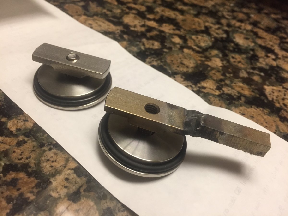

    Thanks for all the advice guys, I used to have the br***/copper other plug that Hot Heads offered but it had a small drip of antifreeze all from after firing up the motor for the first few times (I purchased the motor from another person who stated it was built by an out of state shop, these were already in it) I tried to replaced it myself with the exact part from a nearby Advance Auto parts but it did not expand to seal in the block so I lost my patience & bought these O ringed ones.
    The motor is in a jammed tight in 1930 model A roadster and I really want to avoid engine removal for now, the frame is real close to the hole so the ball hammer can’t make it in there for discs..
    So here in the end is what I did, it seated good & tight now, adding fluid now & fingers crossed! It’s gotta drive to Cleveland Piston Power show in 10 days or bust!!

    shaunez, Man not a damn thing wrong with that. The idea is to get the set screw tight, looks like that ought to work just fine. I am not going to go back and read all of the post on this thread but if I remember correctly I think someone mentioned something like this might work.

    Yeah, well I put it in last night & its leaking already..so many set backs on this build..
    I think in my haste I put the inside beveled edge on that "T piece" in wrong.. if you look closely it can be turned around. Ill try that tonight after getting baptized in coolant once again

    I think upon closer inspection I might have the inner piece on backwards, I believed the beveled area was to allow for block thickness, maybe I am the reason none of this is working! GGRRRR!

    Good idea welding that bar on the end of the "T". I can see these being a real ***** to remove down the road after things corrode a bit and that allen head bolt attaches itself to the T-bar.

    A401D975-69B2-4BAC-ACCA-8C148B65CB18.jpeg I said a prayer, threw some holy water on it & removed the plug.
    Yup, I Turned around the “T” on the back & pressurized the system & I am leak free (fingers crossed!)
    So if anybody ever searches this in the future, look at this picture.
    If you look to the far right this is how they came in a flat sealed package without room to move around, and ***embled... so that is how I put them in.. but due to the counter sink on the block, or just the center hole on MY 392 block it didn’t seal.

    The good thing is all the pieces are stainless steel, even the part we welded on too.
    There is a large O ring on the plug, but also a very small O ring on the Allen head set screw and a recessed area in the plug body for it, it looks very professional
