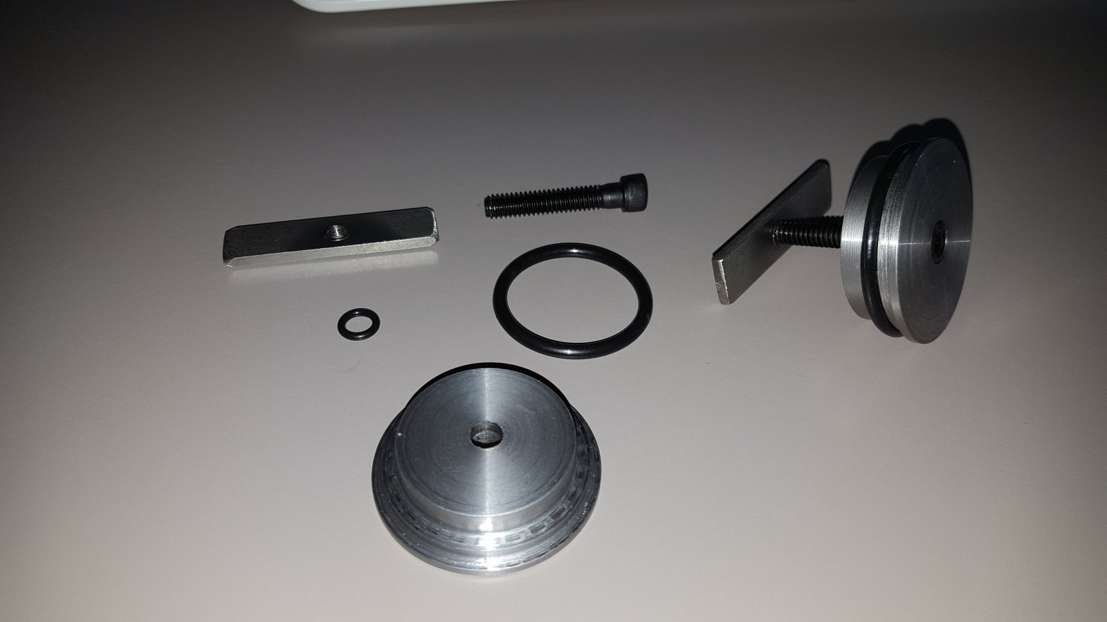

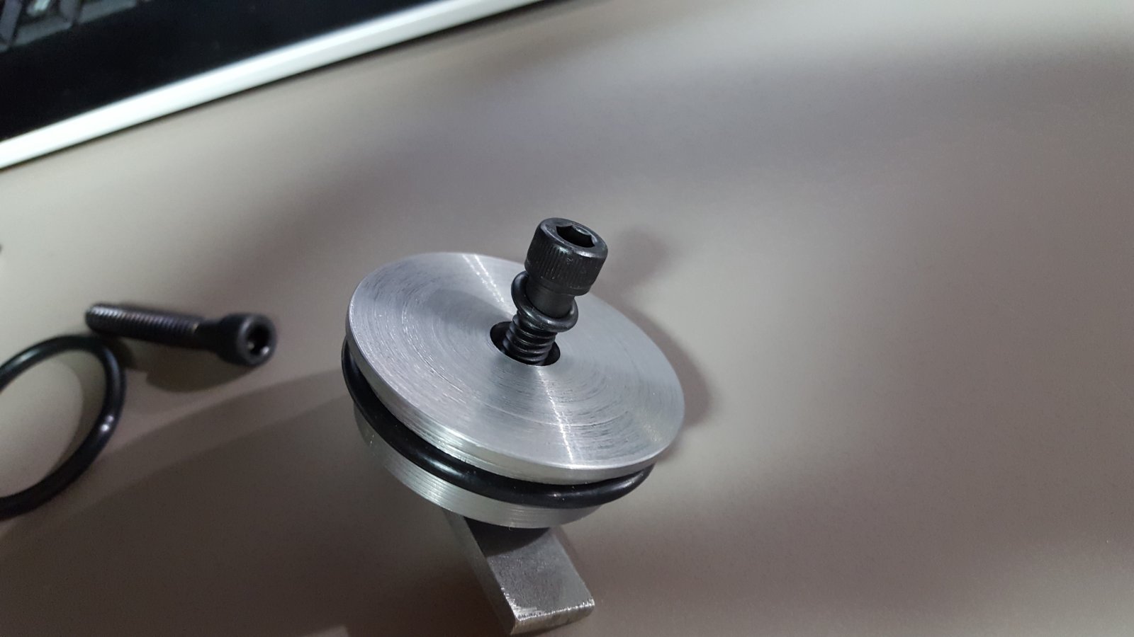

    My 392 kept puking out core plugs, so I made my own. Very similar. I measured each hole, and they were all different, so I made each plug the exact size of the hole so they would seal perfectly and not leak. It's a little hard to see in the photos, but mine have three steps instead of two like HH's. The O-ring is 100% captured and can't move at all in any direction. I put a little Permatex Ultra-Black around the O-rings as I installed them. It's been at least 5 years and I haven't leaked a drop out of any of them.

    No, I didn't buy the HH core plugs. I'm too cheap, so I made my own. The inner most step is the exact same size as the core hole. The middle step is the same size as the land in the core hole, and the O-ring is on that step. The outer land is the largest, and acts as a cap that completely covers the core hole. Here is a photo of them installed:
