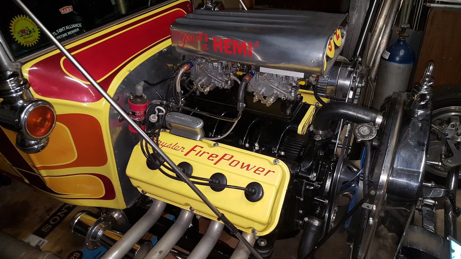

    I know that car! I think we (Dad and I) met you at the Voodoo Kings cruise night at woodfire chicken in Itasca. We would have been in our whiteValiant,and would have been asking questions about your Hemi.

    Yep! I haven't been making longer distance cruise nights as often as I used to. By the time I get off work and get to the cruise night, it's almost over. I've been going to the Broken Oar, Cary, and McHenry cruise nights because they're close to home. I'm hoping to retire soon, and get back to cruising longer distance and having fun.
