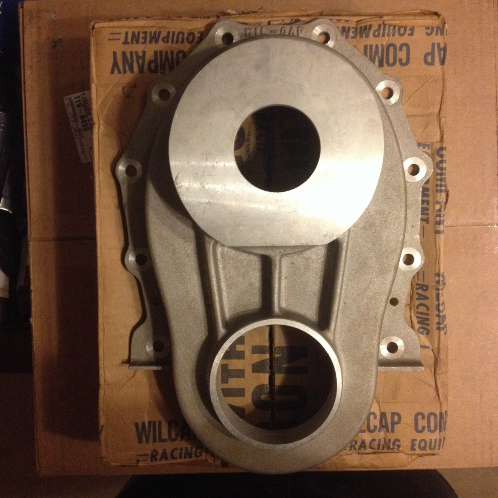

    I have a 58 354 truck block and it has two water outlets on the lower section of the front of the block. I bought an aluminum front cover for an early 331 from Hot Heads and has worked fine ever since .
