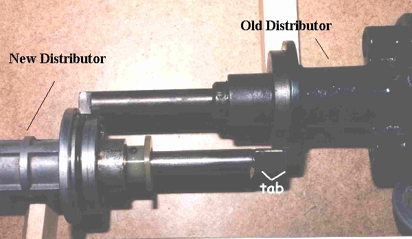

    Pretty standard hemi stuff. You need the 340 adaptor and a byp*** valve blocker both available @ Hot Heads. I am currently rebuilding a '55 331 for a friend and doing all that stuff. The stock '55 oil pump is in great shape so I am using that. I don't buy the distributor adaptor. I just weld the tab on the late model Mopar electronic distributor and file it to shape 1/4" longer. That is all it needs.
