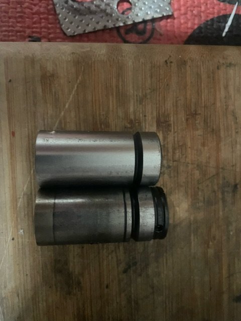

    Same issue here. I have problem at startup with the valvetrain rattling. After about 5 minutes It quiets down. If I shut the motor down and restart it rattles for a short time then quiets. Lifters are not pumping up. My read on what the problem is I discovered the late model lifters have an oil band that is higher than the stock OE lifters. The oil band on the stock OE lifters are lower than the stock lifter. So the moder hyd lifter is not fully lining up on the oil galley. This misalignment I’d delaying the oil from fully pumping up the lifter.fully lines up . The modern lifter oil band partially clears the oil galley.
    I located several sets of stock Hemi (Desoto), sent them to Oregon Cam to have them restore the crown for breakin. Here’s a comparison of the two. The stock OE is the lower of the two.
    I also spaced out some stock pushrods and sent an order in to Smith Brothers to have them made.

    I had Oregon Cam refurbish the lifters by taking them apart and matching the bottom of the lifter and putting a crown on the face. Then they are cleaned and shipped back. Just have to go through the cam breakin procedures. Nothing wrong with replacing lifters as long as they are correctly machined and you follow cam breakin procedures.

    Yeah Marcus, I’m with you. Having heard many horror stories of wiped out lobes I decided to use the tried and true OE Hemi lifters. Cost me about $100 to have the lifters refurbish but worth it for the piece of mind.
    I’ll test out my theory of the lifter pimp up problem when I get the pushrods from Smith Brothers

    This has been covered a dozen times....the only correct lifter is the oem design NOT the post 62 LA. The B&RB lifter up to 1967 is the same. VL-8 or some version of the **-812. Comp Cams '812' is NOT usable as it is a gm part.
    More conversation here: Technical - 1956 354 Hemi | The H.A.M.B. (jalopyjournal.com)
    MaMopar is quite specific about NOT pre-filling lifters after a rebuild, rather let it run and fill up as the oil gets there. This can take 30 minutes and yes, it sounds horrible....
    If a cam has been reground then you will need something to compensate for loss of base circle, usually adjustable pushrods. This also applies to using a lifter that is too short but that will not help the oil feed groove being in the wrong place.
