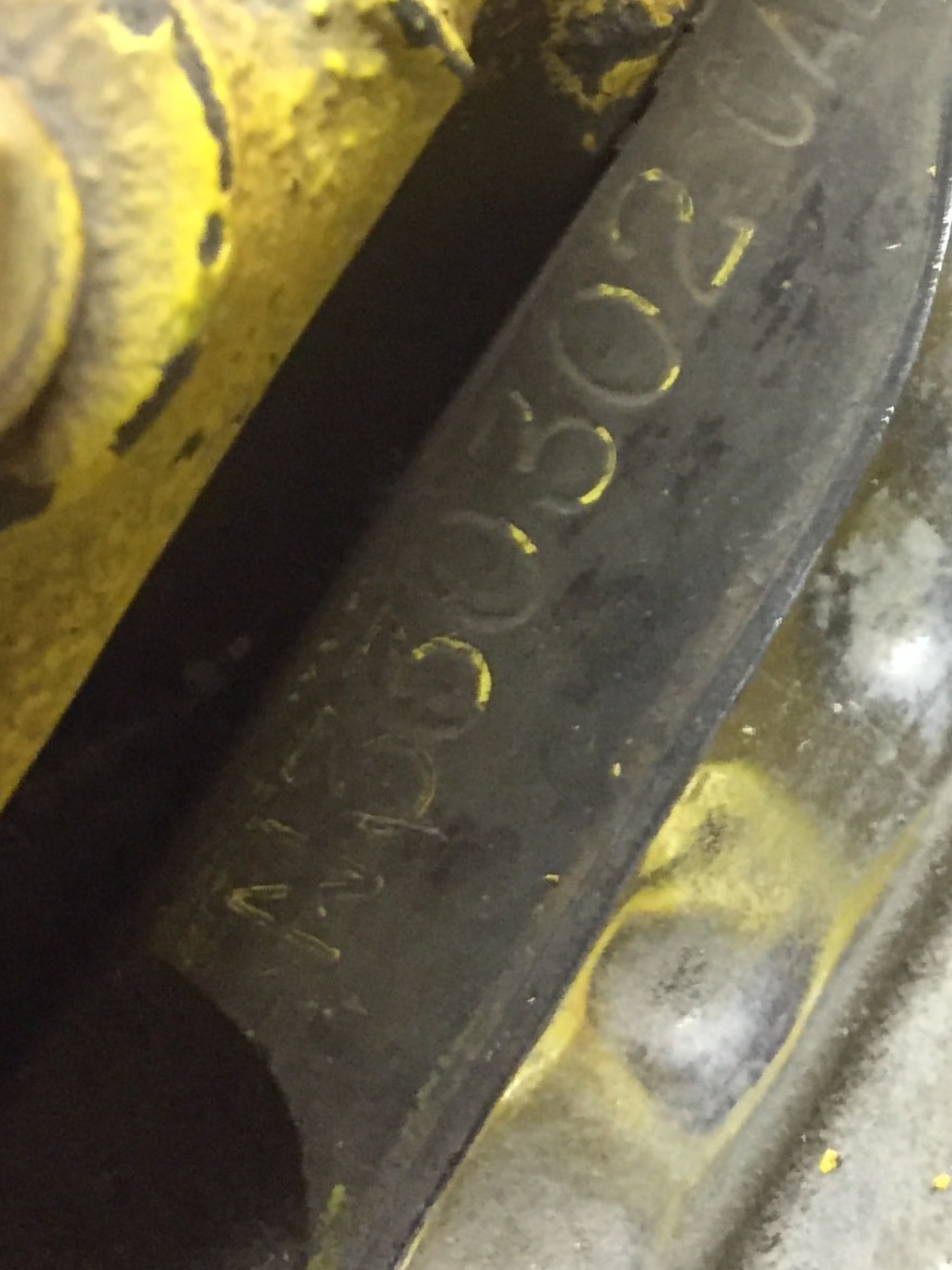

    image.jpeg I know this thread is dead , but I to have found a Hemi with the numbers stamped upside down . My number also starts with an N and ends with CAL . the number is as fallows N330302 CAL . Any help would be greatly appreciated.

    I'll guess that it's a warranty engine that came w/o a use code & a machine shop or owner stamped that on there. Some truck hemis have been reported with use codes stamped on the front of the block below the driver's side head, might check to see if anything is there.
