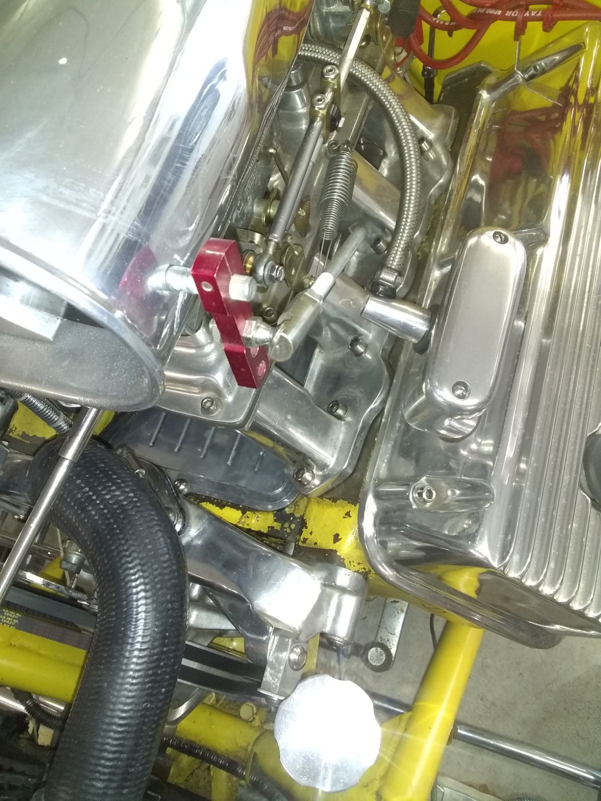

    Can you find and send me a link to buy an aluminum intake for a single 4 carb? Looking for polished if possible. Also, Is a 450CFM carb enough for a street driven 331hemi? Thank you. .............Joe image000001 (3).jpg image000000 (1).jpg

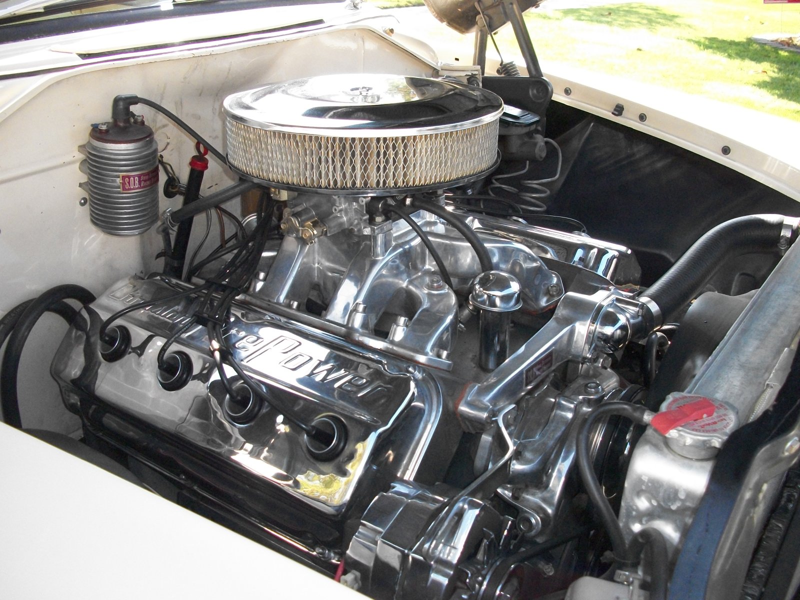

    I'm no Hemi expert, but I got this Hot Heads manifold from them 15-20 years ago. It's a much better manifold than just changing a top plate. I had it polished after I'd removed some cast-in bosses (for nitrous, I guess) that were right above the ports.

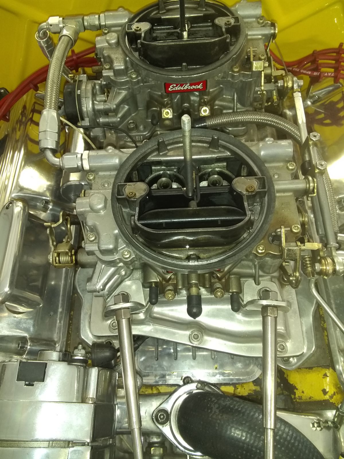

    It's not working. The carbs operate together. I can't figure out the electric choke on the front carb only. Which to me isn't right if the back carb is just opening with no choke. It has a hard time starting. Sometimes it floods. And when I do get it to start, I have to keep the rpms up til it gets warm so it will idle on it's own. I really think the set up now needs the linkage to be progressive and the choke needs to be dialed in. Then, maybe I would be fine with the current set up.

    Unless I see your picture wrong, the choke is on the rear carburetor.

    That is not a Hot Heads intake, but an older PAW tunnel ram. The tops do not interchange. PAW made a bunch of different top plates for that intake including a single 4bbl, but there hard to find now since PAW went out of business. The Hot Heads dual plane would be the better way to go.
    Changing to a single 4bbl will also require reworking your throttle and transmission kick down linkage(***uming you have a torqueflite)
    As for carburetor size, a 600 cm would work well and be the cheapest.

    Take a look at the front carburetor.
    The front p***enger side hold-down bolt has the carburetor part numbers in front of it.
    Like this:
    I do not recall Edelbrock making a 450, but I could be wrong.

    Choke on the rear carburetor would be correct.

    Correct, the A.I.U intake and the PAW intake are one in the same.

    Below is a better pic of the intake. The carbs #1403 so now I know they are 500cfm.
    So, I changed the spark plugs. To me, the gap was tiny on the old plugs. Measured .05. So, I gapped the new plugs at .76. The engine wouldn't fire at all. Flooded to hell. I re-gapped the plugs at .05 and it fired right up. Didn't think plug gaps were that crucial. But, still wouldn't stay running until warm. I think carb rebuild is needed. I know today's gas ruins these carbs when sitting. Just going to keep at it until it is fixed.
