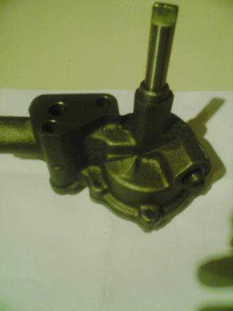

    Hi Desoto Hemi experts.
    you have a look at the attached photos, the first one is the stock pump out of my 330 Desoto the next one is a new pump that came with the motor. And the third is the two together. The new pump is a different shape and would require a new pick up but will bold up to the motor. From initial measurements it would need about 3 mill taken off the mounting surface to totally engage the drive dogs.
    Is this possible or am I heading for disaster? I see you can buy replacement pumps for Chrysler but everyone only sells rebuild kits for Desoto. It it this simple or have I missed something?
    Next question is the oil byp*** valve, my motor does not appear to be fitted with the byp*** valve as referenced in the Tex Smith hemi book. Did some of these motors come out without the byp*** valve? Or am I mistaken? I have inserted a rod in the oil pressure hole at the top of the block and tried to tap the valve out but it is a solid bung in the block when hitting the rod the block rings. I have checked out the oil flow and it appears it is total flow through the filter. any thoughts or suggestions

    All OEM pumps now available are rebuilt, not new unless you happen to find a NOS somewhere. Leo's book shows 2 part numbers for high deck Hemis Chr, Dodge & DeSoto. So a rebuilt 392 pump should work on a 330. There might be a difference between the rear sump pump & (certainly) the pick up vs a rear sump., might be why there are 2 part numbers.

    Thanks George, I spent a few hours searching and believe the new or rebuilt pump I have is from a centre sump motor. It is somewhat shorter than the original pump. Are you suggesting it is a 392 pump?

    As said, the HV 340 puts out the same volume as the stock 392. Melling did a flow test years ago. Why mess with adapters and odd ball intermediate shafts?? The DeSoto pump in the picture is the same as a 354 Chrysler. The 392 style pump was also used on 315-325 Dodge. If you want to use the 392 pump in a rear sump pan then a new pickup tube and screen is needed. A pickup tube ***embly for a late Dodge pickup truck, LA type small block, fits all of the requirements except for being too deep into the pan. Make it shorter.

    What everyone has failed to mention is that there are two different mounting flange bolt patterns with the screw in pick-up style pumps. The 392 pattern (also late 354 truck) is different than all the rest of the Chrysler, Dodge, and Desoto.
    (This is why one bolt hole on the adapter plate of the converted 340 pumps is slotted) ;)

    ...Respectfully disagree about the 392 pump being different from all others. There are two (2) mounting pad designs, 51-54 and 55-58.
    The 392 'style' pump was also used on Dodges and DeSotos, different part numbers, same pumps.

    Well I’m not positive what pump I have but I think it is from a centre or front sump installation.
    Measured it up and took 60thou off the pump mount surface to get the drive at the same height as the pump that was fitted to the Desoto. Cutting down a 318 pickup to match everything up. Will get some better photos this weekend
