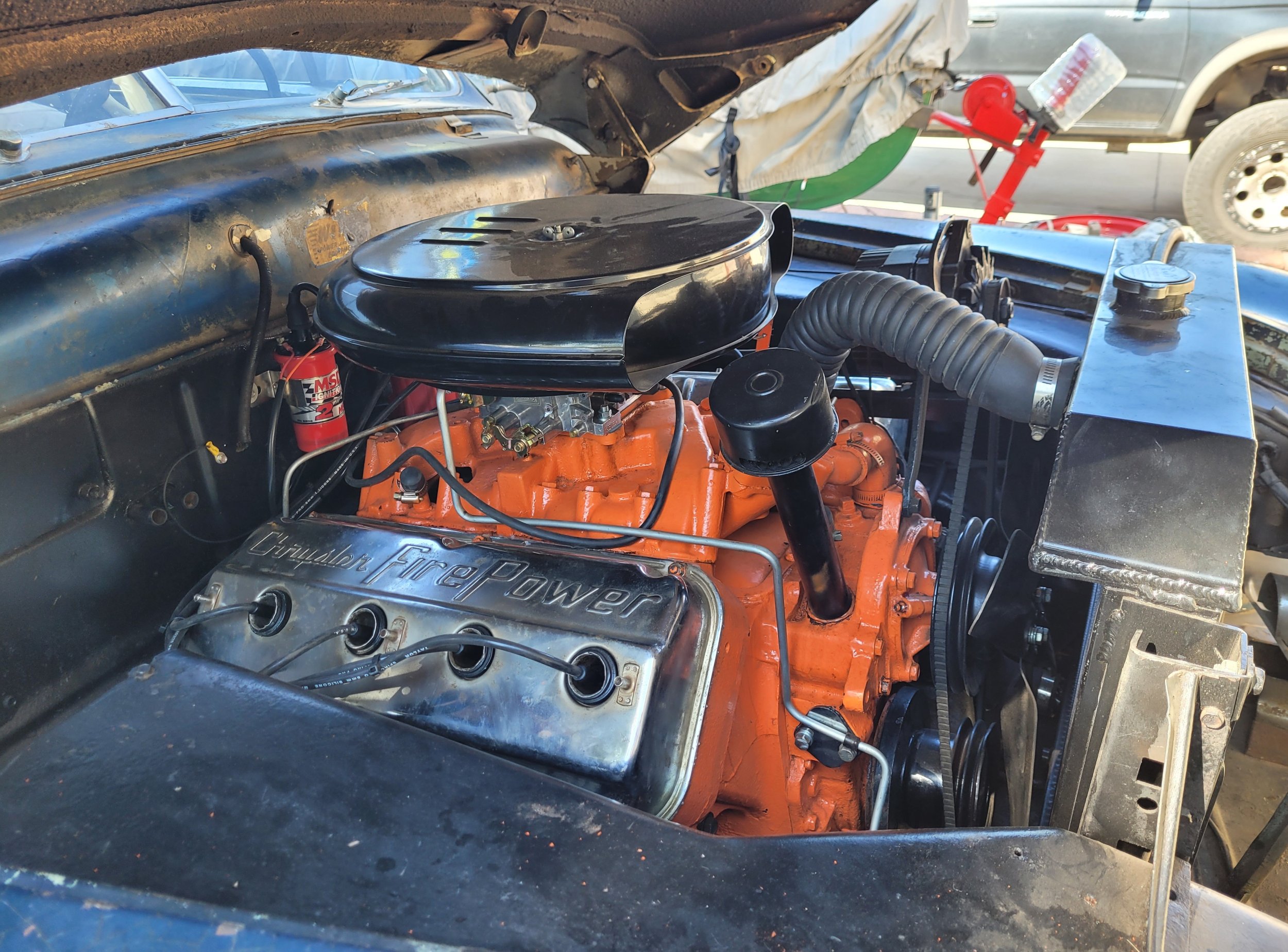

  7. 51 mercules
    Joined: Nov 29, 2008
    Posts: 4,430
    51 mercules
    , 331hemi (1).jpg it If its a late 54 Hemi with the short bell like mine, it has wet intake manifold and is a lot of trouble to run some other intakes unless you use 55 Hemi heads that have the water ports in the head or maybe a remote thermostat housing?If you don't have a wet intake for the hemi, theyre kind of hard to find. Will have more options for intakes with the Olds.
    Tow Truck Tom likes this.
