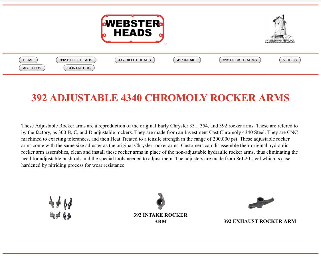

  14. TRENDZ
    Joined: Oct 16, 2018
    Posts: 386
    TRENDZ
    Weird break for sure. If you can’t find a local replacement, pm me.
    If you’re looking for something better... D4629067-A96E-42EF-B9CF-C3CEB0B991A0.jpeg
    IronFord and 30dodgeboy like this.

    My good friend Gary Patrick at Rocker Arms Unlimited also has some nifty pieces that are investment cast stainless for folks with a good budget.
