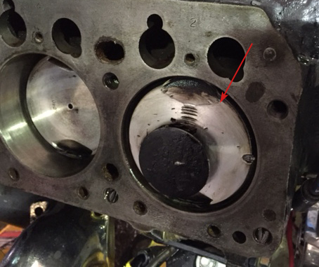

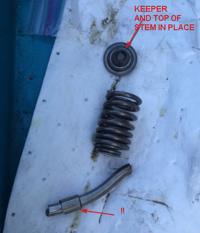

    Should have posted these with my original question. Notes are a bit redundant.
    The Head of the Valve stem is still in place. Guide didn't do so well,
    Broken valve head punctured the piston, but did not damage the cylinder wall.
    The OEM non adjustable pushrod was NOT bent, nor did the rocker arm appear to be damaged.
    I'm inclined to come down on the side of Valve spring travel, or similar. One reason is, we originally ***umed it was a valve defect (Fresh Motor and all that). , and while we replaced ONLY the broken unit, used the same springs. I am embarr***ed to say, i do not know the cam specs. [long story] but I'm gonna find out
    Luckily there was Zero damage to the connecting Rod and cylinder Bore.
    Thanks for your help

  11. Mengestwinspeedshop
    Joined: Sep 27, 2008
    Posts: 42
    Mengestwinspeedshop
    from Santa Rosa
    Could the guide be causing a problem, being too tight? Looks like part of it stuck to the valve on your arrow with exclamation marks.

    Looking at the photos I see part of a guide and I see double springs...
    Is the guide firmly stuck on the stem? Some folks set up an EarlyHemi as if it were a brand-x engine thinking that there is m***ive amounts of oil flying around. Bad ***umption. It is actually easy to seize a valve with too little stem clearance because there is too little lubricant.
    Double springs. They should be tested to see what they are. It could be that if the spring is some monster and there was a flaw in the valve stem then the tip separated. Add in any additional problems like the retainer contacting the under side of the rocker arm and disaster follows.
