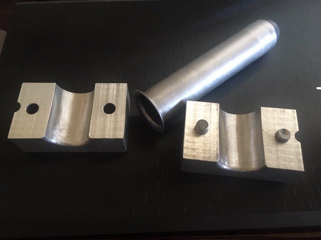

  24. Never2old
    Joined: Oct 14, 2010
    Posts: 743
    Never2old
    from so cal
    I bought some tubes a while back (years) and now as I am finally putting the engine together I discovered that they were too long.
    So I decided to shorten them instead of ordering more.
    Here is the tool I made to reshape them.
    Once I determined what length I needed it was easy to make them all alike.
