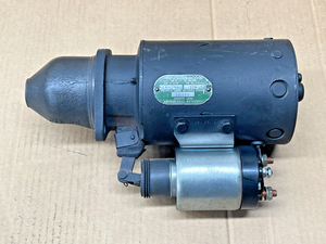

  14. 73RR
    Joined: Jan 29, 2007
    Posts: 7,343
    73RR
    1957-1958 looks like this:
    Finding a good one may be tough but they are rebuildable so a core may be the route to go.
