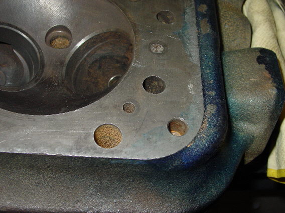

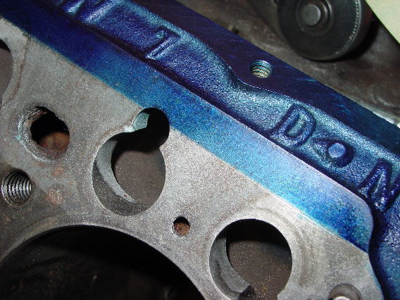

    from Portage,IN
    I'm replacing my trk heads (cracked) with 331 (1486833) heads.
    Everyone say's they fit. I found that they don't quite cover the
    push rod holes in the block. The gasket will proably cover good
    enough to stop a leak. (dab of silicon?) Just wondered if anyone else
    has run into this situation. Here's a pic of the block.
    Rich

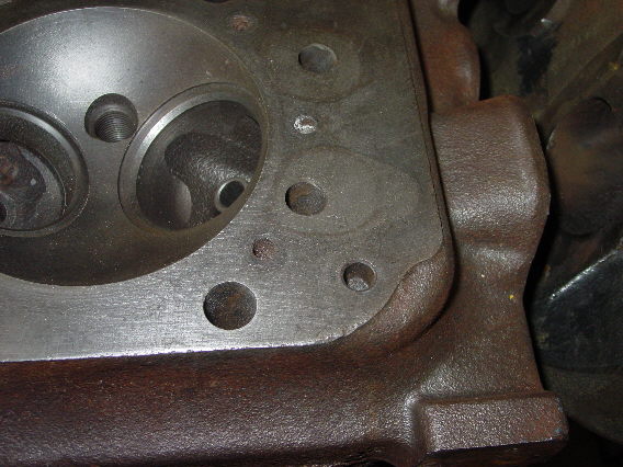

  30. Rich B.
    Joined: Jan 23, 2008
    Posts: 761
    Rich B.
    from Portage,IN
    Here's pics of the two set's of heads.
