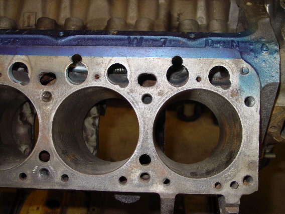

    Make sure that your head gasket has holes in all of the correct places then clean the casting and fill the upper portion with JB weld.
  3. Rich B.
    Joined: Jan 23, 2008
    Posts: 761
    Rich B.
    from Portage,IN
    JB weld sounds good. I wish I knew what the xtra holes were
    for above the lifter access hioles. They are not shown on any
    other heads. I'll use the gasket from a car 354 instead of
    the truck gasket. The holes in the heads match all block
    holes. The 331 heads are supposed to be 54's, have the good
    ports. Had them magged!

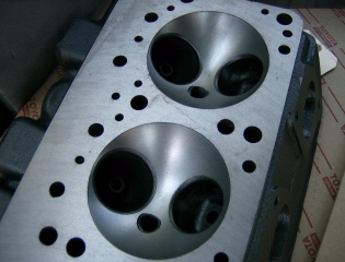

    Rat Bastad has got a blown 330 Desoto in progress and has taken the time to show us the porting and polishing job he's done on the heads. Very impressive work! Makes me want to go out and clean up the heads I have layin' around...
    Thanks Rat!

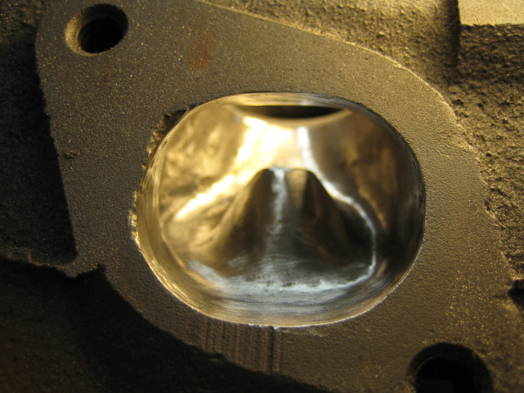

    Just a little word of caution here guys on porting. Looking at your heads. Intake port inside, see the little bump in the port wall? Be careful grinding in there. If you grind the bump out, you WILL be sleeving the pushrod hole. Lippy

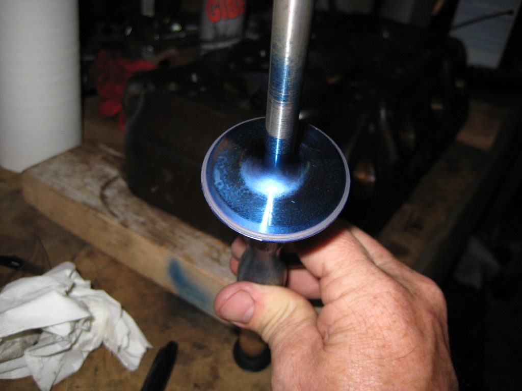

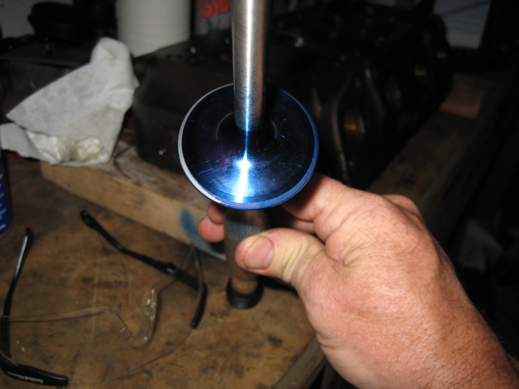

    Since this is Hemi Head tech, I thought I would add a couple pictures showing the results of my new cnc program to resurface the Chrysler early hemi combustion chambers. This will really take the hurt out of those heads that have been sitting in the weeds for 50+ years. This will also true up the chambers, which were done manually by the factory when produced.
    Most heads will need to be surfaced as part of the standard rebuild process, so chamber volume is not going to be adversely effected. This program can be modified to adjust the diameter as needed.
    Programs for the Dodge and DeSoto are in the works.

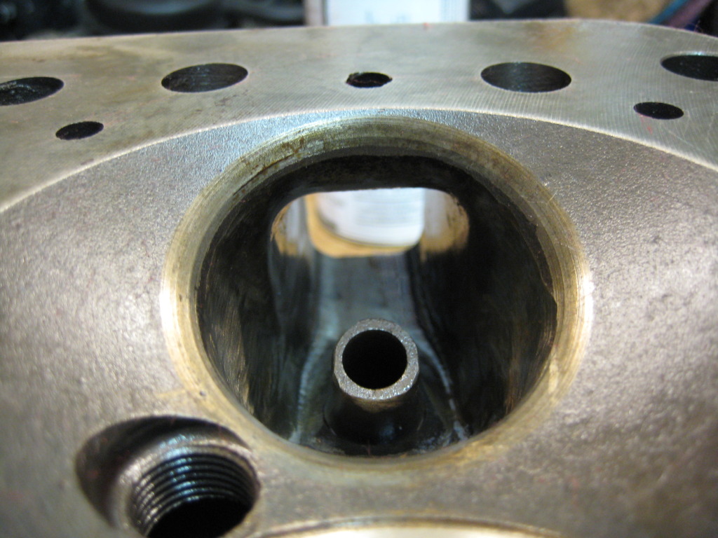

    I recently finished porting my 330 Desoto and thought I'd throw some pics on this thread. I didn't read the warning above about the intake runner bump - guess I got lucky :). The valve seat in the intake side was not touching for 1/2 of the valve. There is a lot of threads for and against valve lapping, I decided to lap the intakes ( about 1/2 of them had contact issues ). These heads were machined and ***embled about 10 years ago and never installed. When I got them they were full of rat turds and a little spot rust. So the guides are not worn. I had Johnny Thomas put in the hardened exhaust seats. The exhaust seats all had perfect contact markings. A lot of work. I hope its worth a few ponies anyway.
    Deuces likes this.
