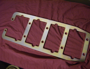

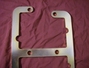

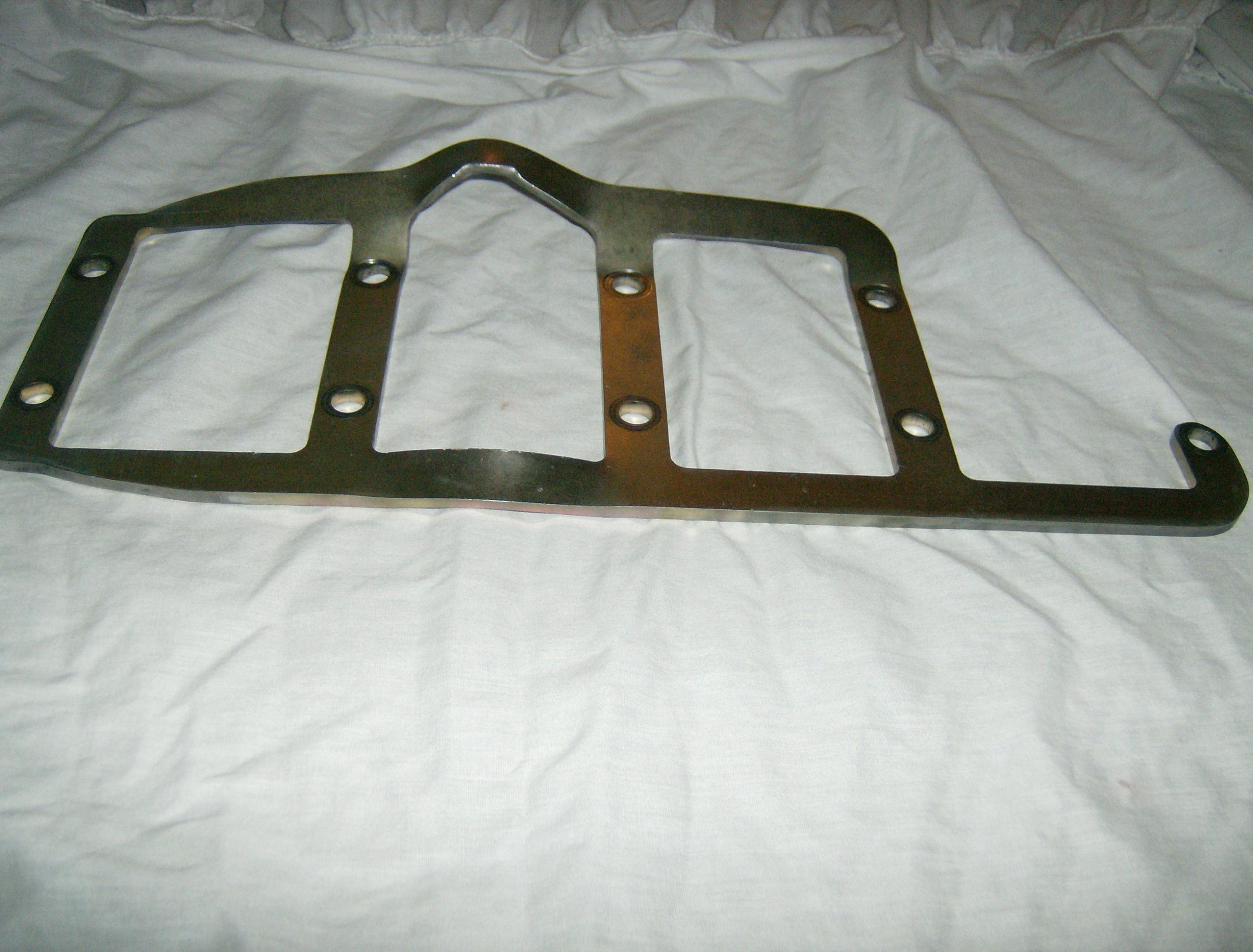

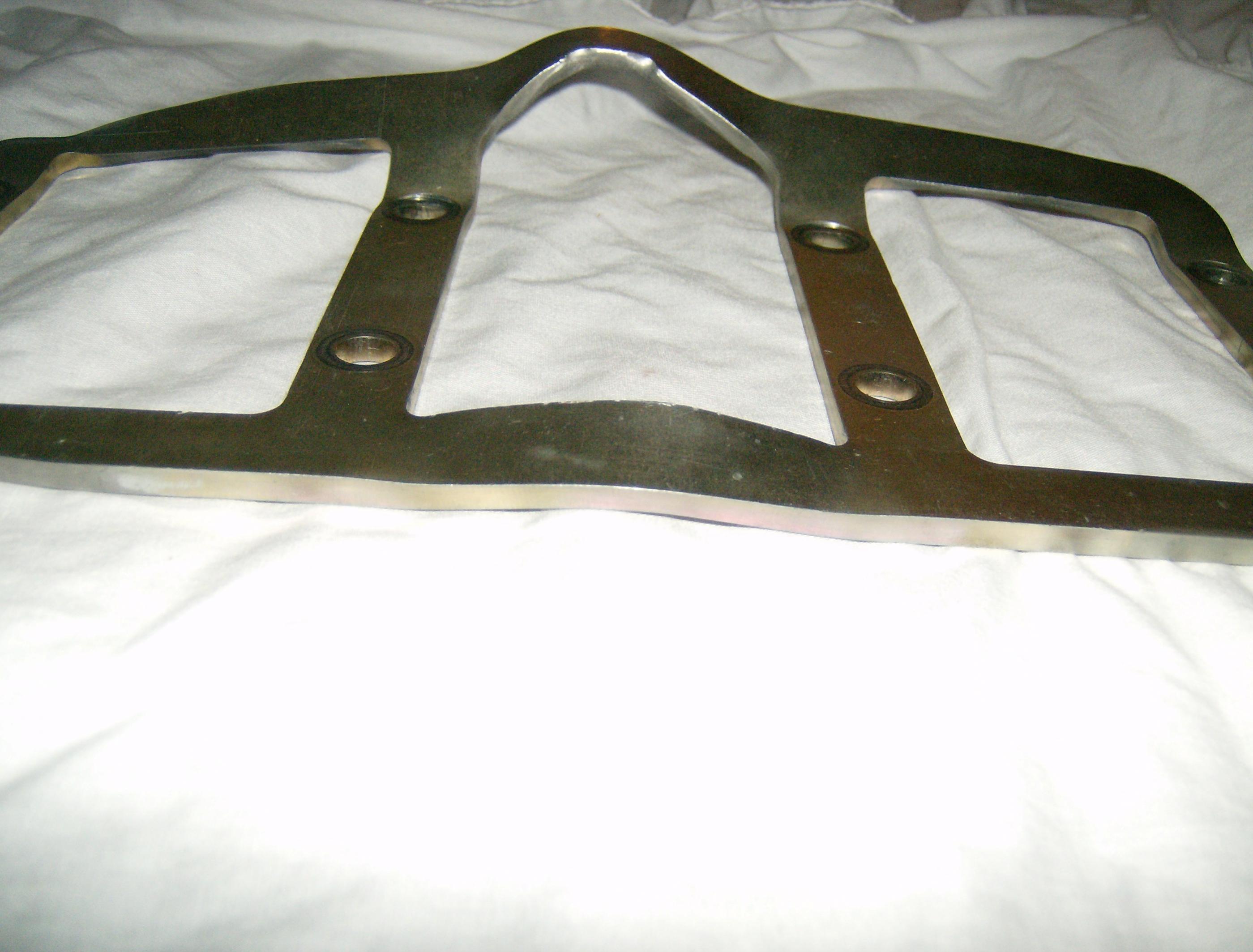

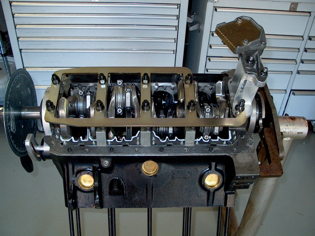

    I thought I would share a couple "spy photos" of my new and improved HD main cap girdle available for the 331/354 and 392 Chrysler Hemis.
    My new HD girdle now picks up all ten of the main bolts, vs 9 of the bolts on the std versions for Chrysler, Dodge, and Desoto. The new girdle does require very minor clearancing of the stock oil pump for the bolt. It clears the aftermarket pumps (SB Mopar with adapter) without any modifications.
    The HD 331/354 girdle is now the same overall width as the 392 girdle, and includes the rod bolt clearance notches.

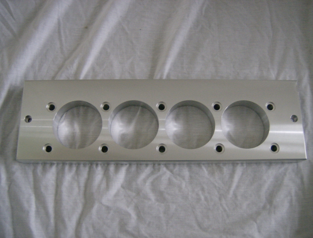

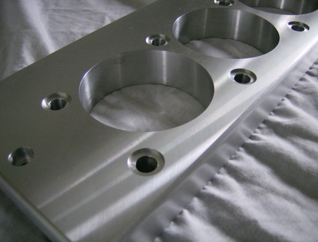

    I thought I would post up a couple pictures of my new torque and/or honing plate for Chrysler early hemis.
    I made this from 1.5 inch 6061 aluminum. It is made with a 4.075 bore. I used aluminum because I have an upcoming project which is using aluminum heads.

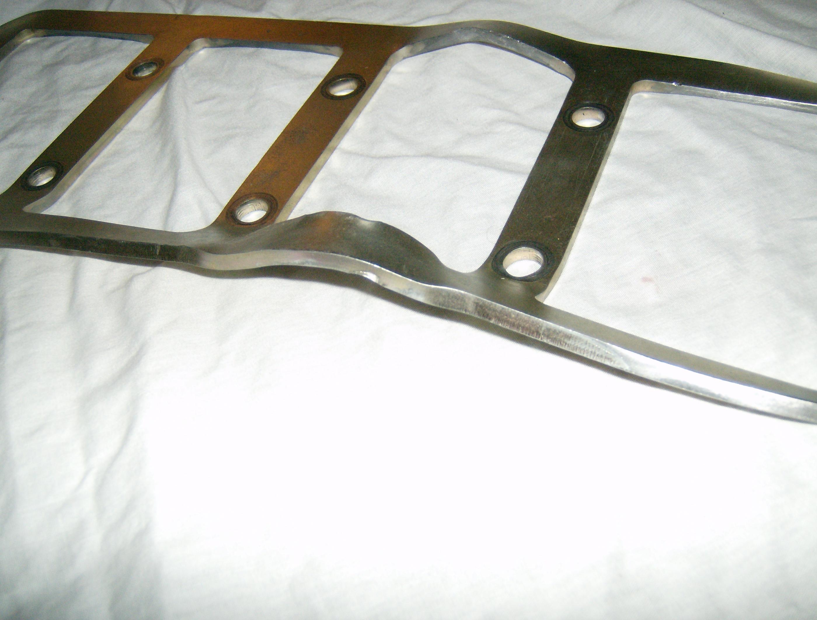

    I thought I would post these pictures up for some show and tell. This girdle is from a 354 hemi jr fuel engine which broke a rod. The block is being magged for cracks in the main webs. The general consensus is that whether or not the block is cracked or not, the damage would have been much greater to other parts had the girdle not been installed. The girdle prevented the broken rod from breaking out the bottom of the cylinder into the water jacket, which happens 99.9% of the time with a rod failure.
    There are those who will argue that if the girdle wasnt there, and if the rod had broke close to the crankshaft, and if the piston didnt drop in the cylinder...well...you get the idea. :rolleyes:

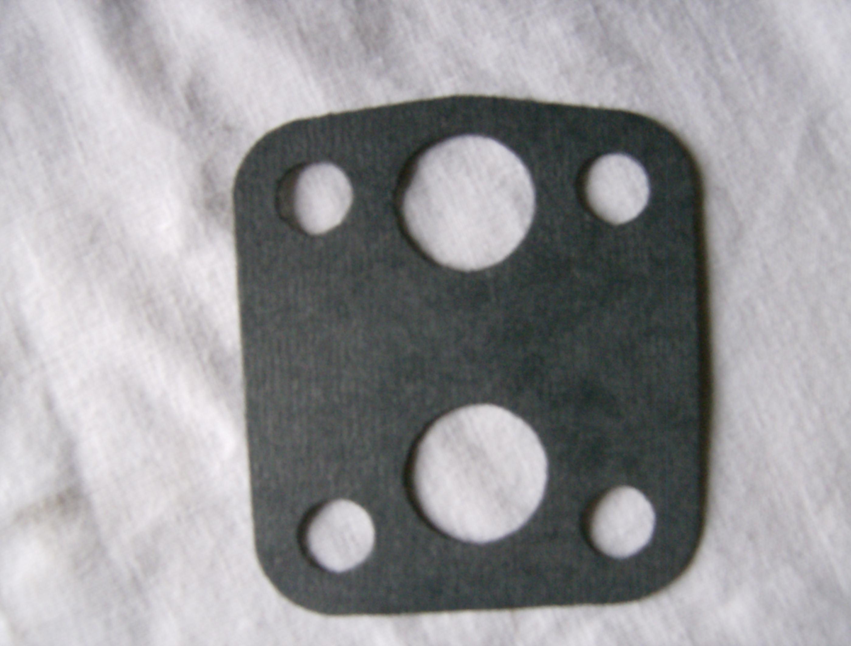

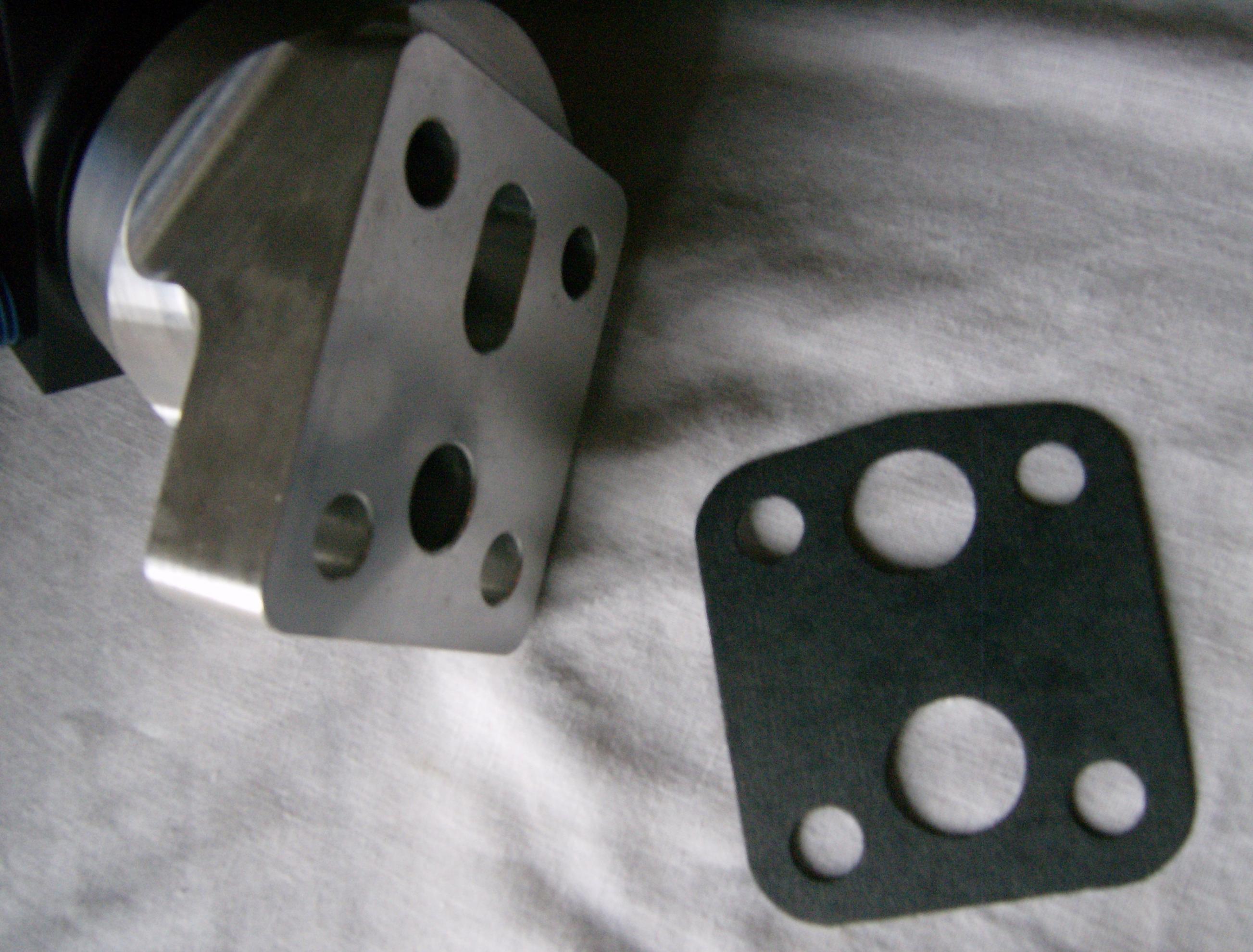

    First time offered...anywhere. This auction is for my newly released early hemi oil filter mount to engine block gasket. Precision laser cut for an exact fit. This can be used on all makes and sizes of early hemi engines. Previously unavailable unless you bought a complete gasket kit. Made in the U.S.A. of N-8090 premium gasket material.
    N-8090 has a latent cure nitrile butadiene rubber binder and reinforced cellulose fiber. It has excellent oil resistance, good sealing characteristics, and is intended for applications with short duration maximum temperatures up to 180°C (350°F).
