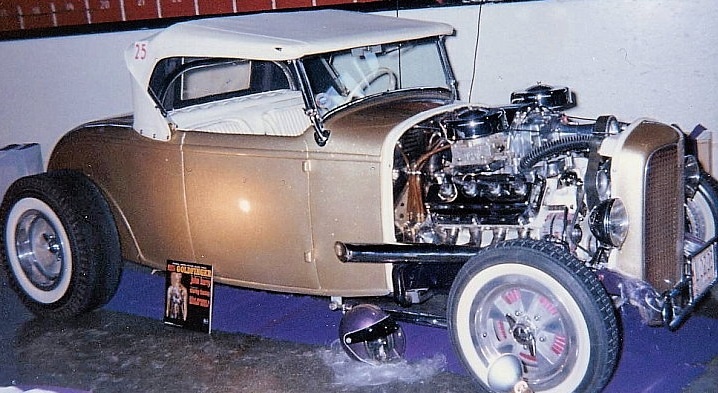

  6. Does anyone have any info on how these upper radiator hose are coming off the blower manifold? For specifics this is the original "pineapple princess" .
    Maybe there's some more pics in your stash-
    Maybe you did the work.
    Now for non specifics how about some discussion on pulling this off.
    I have a crager manifold that I've been thinking about trying to pull off, been thinking on and off for a while. Wondering of course if i was the first one to contemplate then. Then I find this picture.
    I think some different hoses/hard lines would look pretty damn neat.

    Those are really quite large hoses going to the manifold...there must be some sort of reducer at the manifold, then ya gotta wonder why he just didn't use a smaller line to the rad...
    None of the heads/manifolds have that size coolant port/hose connection so no clue what the builder had in mind.
  8. This unit is powered by a 1953 Chrysler New Yorker, Hemi, bored to 364 cubic inches. The pistons are 8.2 to 1 Forgetrues. The cam is a Isky E-2 and the Hi-Rev kit was also supplied by Iskenderian. A Scintilla Vertex Magneto replaces the stock ignition, and a '61 Valiant alternator replaces the original generator. The intake manifold is a Crager blower manifold which mounts a 4.71 GMC blower. The whole ***embly has been balanced. '56 Chrysker truck heads have been fully ported and polished and fitted with sodium cooled exhaust valves. Exhaust headers were built by Glen Smith.
    Found this ^^^
    http://www.wagondriver.com/roadster.htm
    Truck heads have different center cooling outlet. Maybe that's a clue??

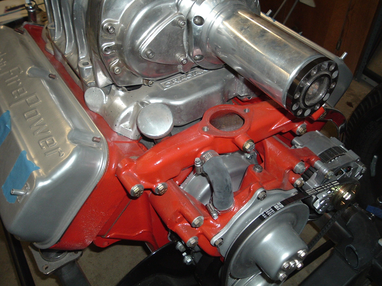

    [​IMG] [​IMG] Ask and Ye shall receive......... This would be related to the Cooling thread...... Still have to tap a boss on the drivers side for the h20 gauge. But- don't think I'll be too happy with a standard h20 neck that comes straight up= blower snout is very close,and would like something in the 90 degree range. Might have to make an adapter to fit a sbc neck......So recommendations sought. Running the stock front pump/housing/cross over. still figuring things out,but here's the money shot of the intake.
